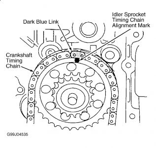

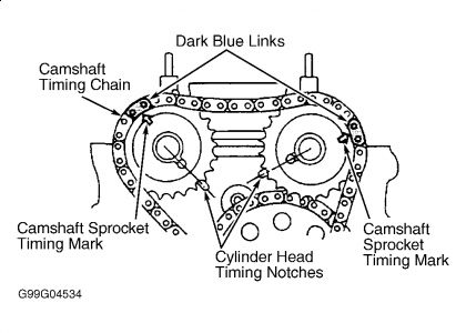

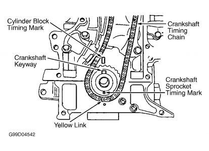

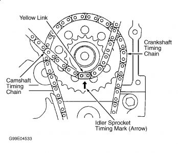

What are timing marks for 2000 chevy tracker 2.0 engine

https://images.2carpros.com/forum/automotive_pictures/261618_Graphic_397.jpg
https://images.2carpros.com/forum/automotive_pictures/261618_Graphic2_57.jpg
https://images.2carpros.com/forum/automotive_pictures/261618_3_45.jpg
https://images.2carpros.com/forum/automotive_pictures/261618_Graphic4_3.jpg
