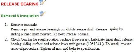

WHAT IS THE PROCEDURE TO REPLACE THROW BEARINGS

https://images.2carpros.com/forum/automotive_pictures/261618_Noname_2025.jpg
