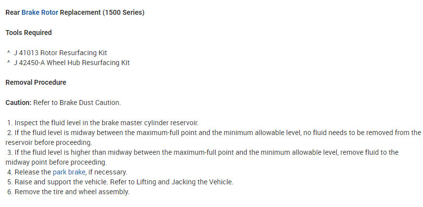

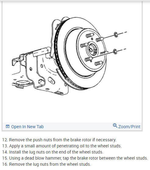

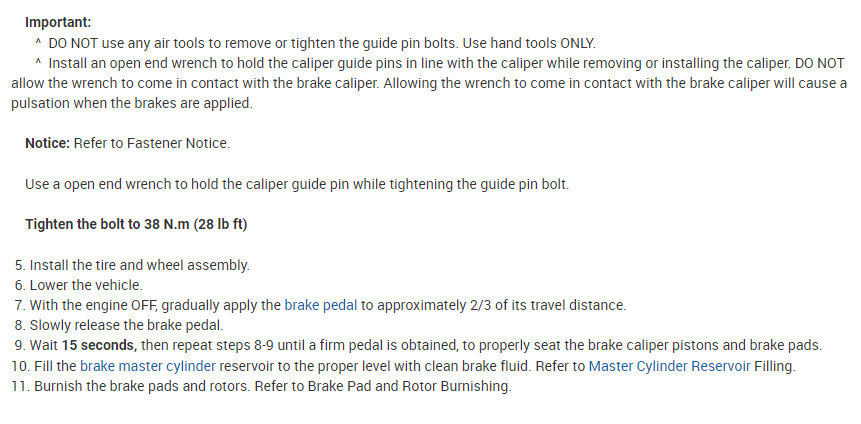

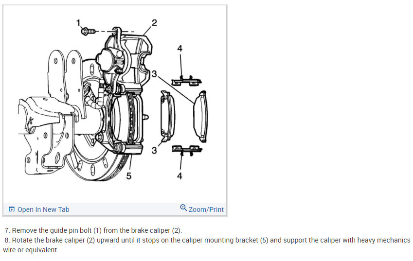

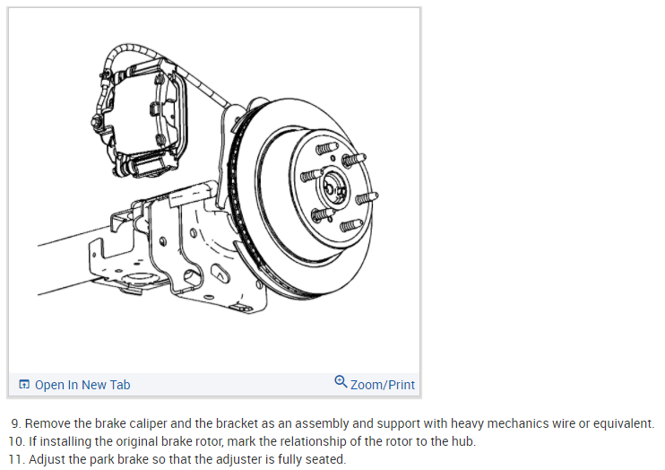

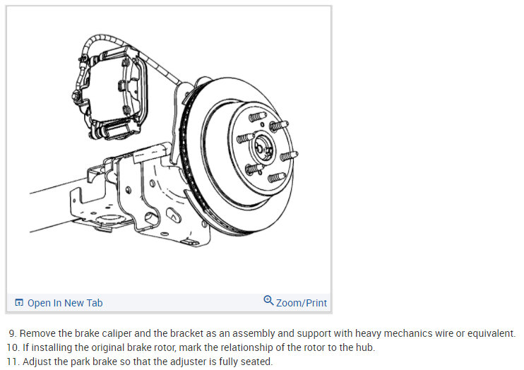

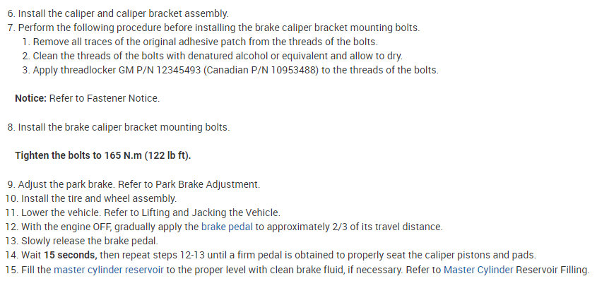

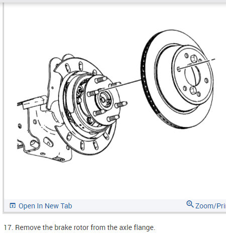

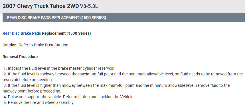

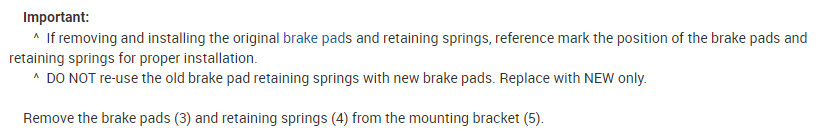

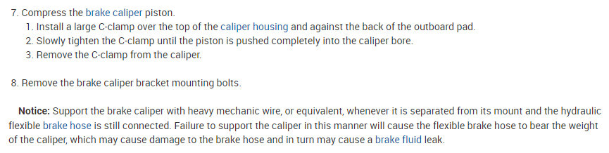

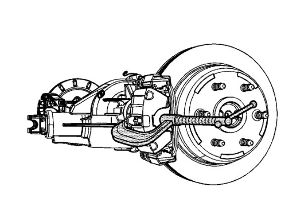

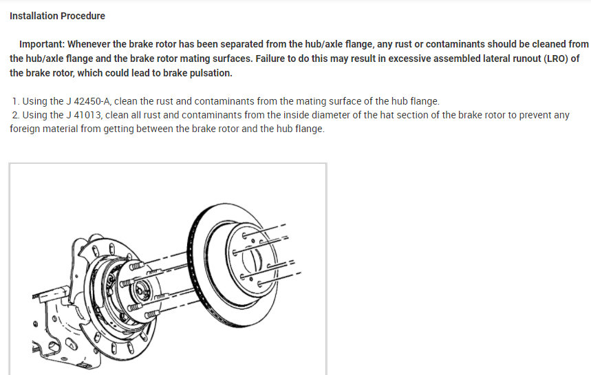

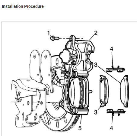

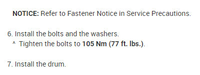

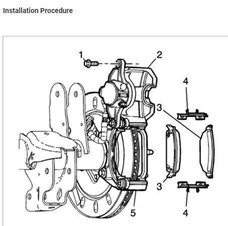

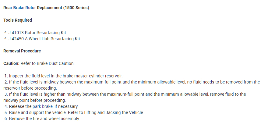

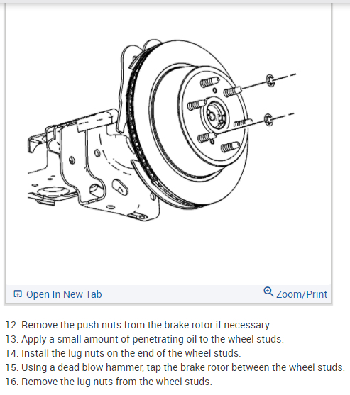

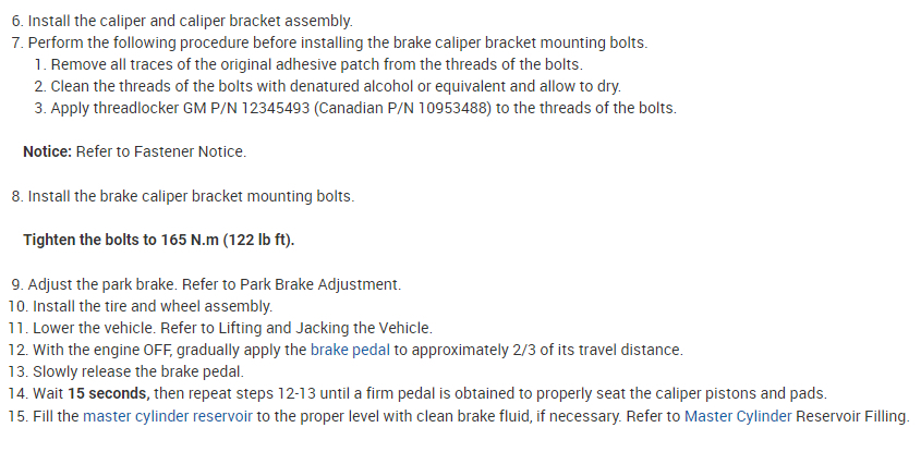

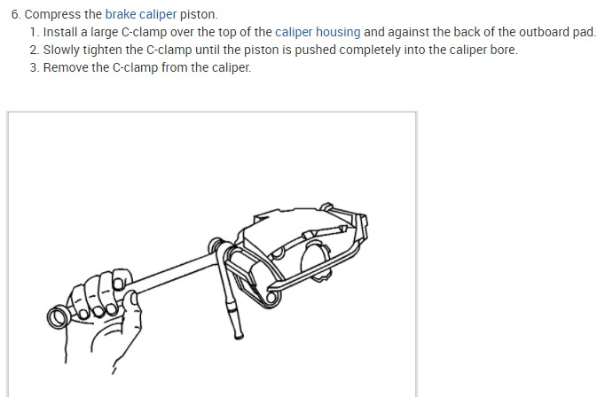

I am just wondering if you can give me the info on how to do the rear brakes? Thank you in advance.
Aug 24, 2009 at 1:39 PM
DANNY L
  • 5,648 POSTS

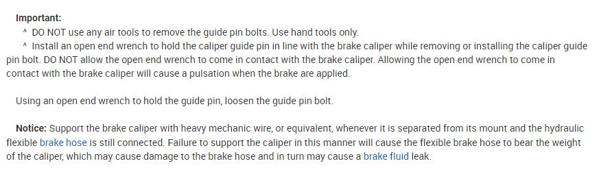

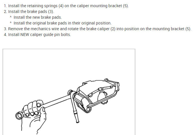

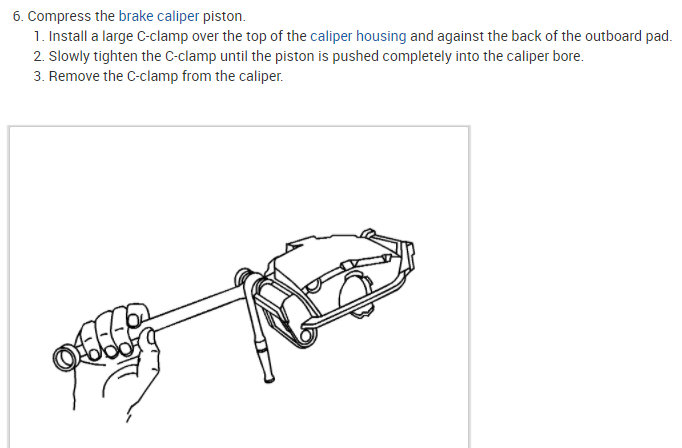

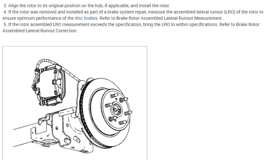

Here is the information you requested. Here is a tutorial on how to remove and replace rear brake pads and rotors: Here is a YouTube video from our site on how to compress the rear caliper piston when performing a rear brake job:
https://youtu.be/PAjUx1Rct4Q
and
https://www.2carpros.com/articles/how-to-replace-rear-brake-pads-and-rotors
I've attached picture steps below on how to replace the brake pads on your truck. Hope this helps and thanks for using 2CarPros

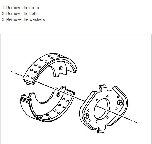

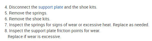

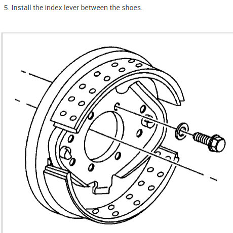

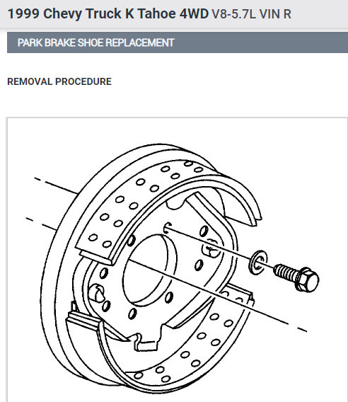

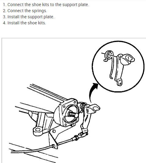

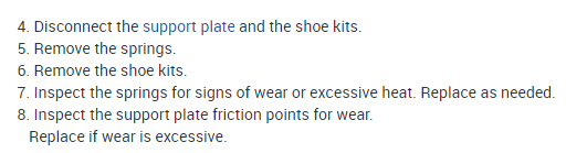

Hello, I'm Danny.

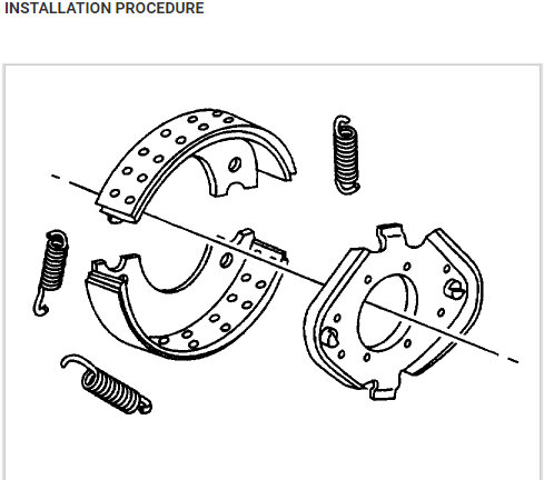

Here is the information you requested. Here is a tutorial on how to remove and replace rear parking brake shoes:.
https://www.2carpros.com/articles/parking-brake-shoe-replacement
Here is a You Tube video from our site to view as well:
I've attached picture steps below on how to replace the parking brake shoes on your vehicle. Hope this helps and thanks for using 2CarPros.
