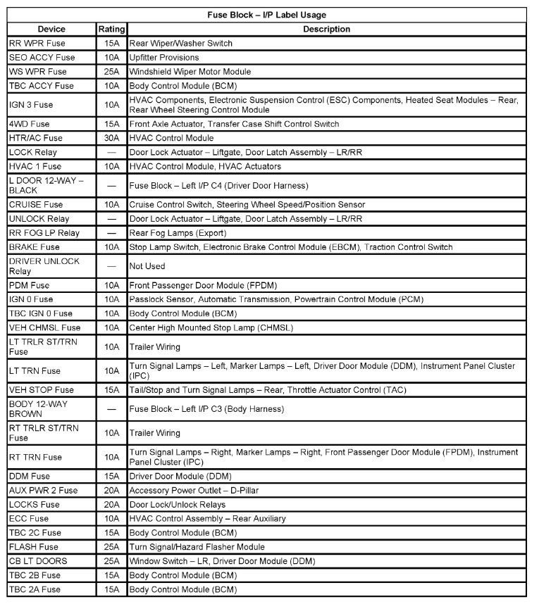

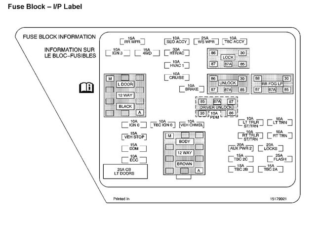

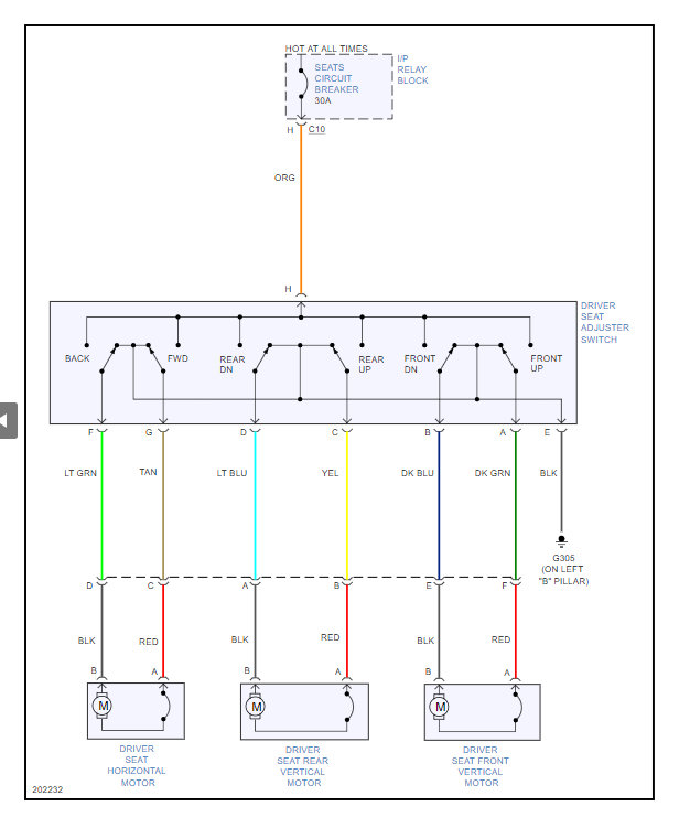

My driver electric seat stop working. I have checke the fuse box in the hood and the one by the door but all the fuse are Ok. is there any other fuse or what could be the solution to this problem?

Hello, did you check for voltage at the fuse circuit? Use a testlite. Let us know exactly which fuse you checked and the location. My info showed several fuses and a circuit breaker for the seat.

I have checked the one in the hood and the one by the door but i can not locate the breaker box

https://images.2carpros.com/forum/automotive_pictures/170934_07_chevy_tahoe_1.jpg
CB3 should be the circuit breaker for the driver seat. If you look at your owners manual, it should give you the fuse labels and locations. Again, did you use a testlight or something to check that the fuse circuit is hot???? Even if the fuse or circuit breaker is good, if there is no voltage to the circuit, it won't matter, the circuit is dead.

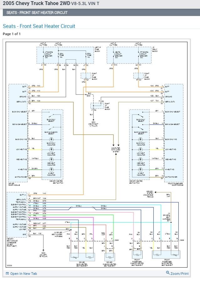

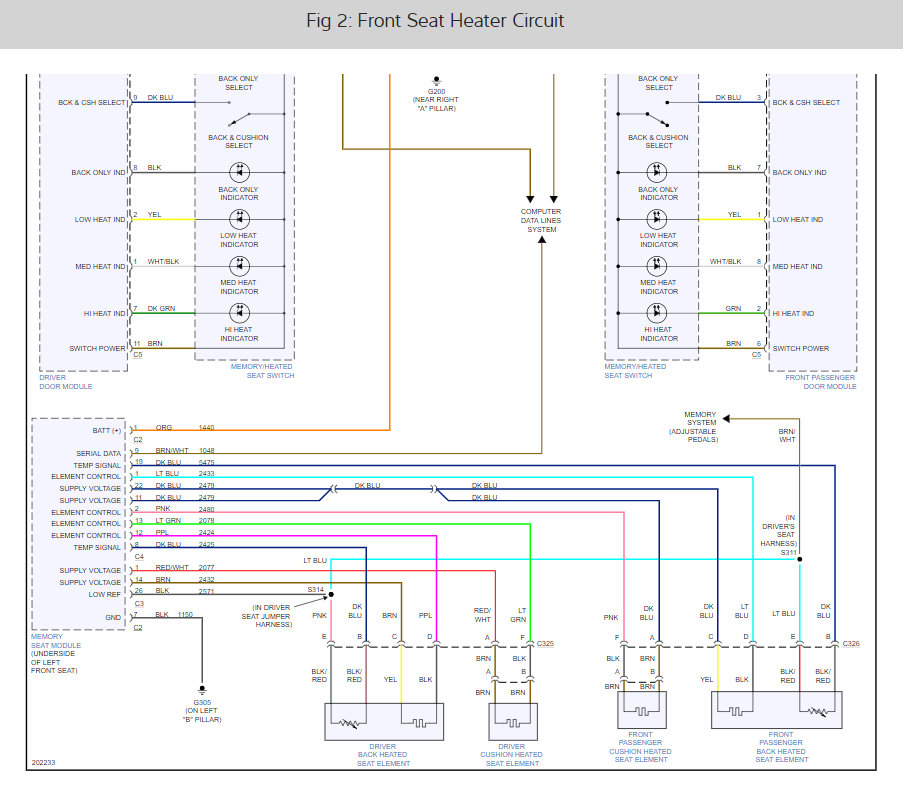

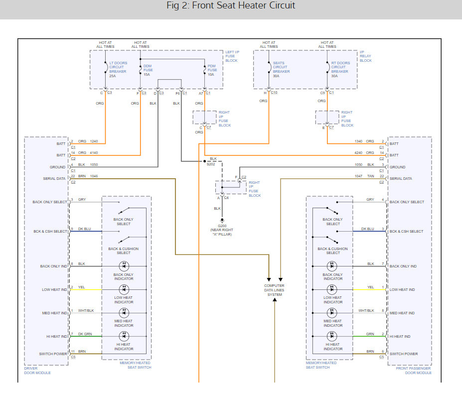

Heated seat switch does not work and the power seats as well. I cannot find a fuse or relay.
Nov 27, 2020 at 2:52 AM (Merged)
SAMANTHAJ
The heated/power seats are run off circuit breakers for the most part. There are two fuses in the interior fuse panel (DDM and PDM) that power the drivers side and passenger side door modules. Check the guide below on testing wiring and the diagrams for the seat wiring. Let us know what you find.
Check out the diagrams (Below). Please let us know what you find. We are interested to see what it is.

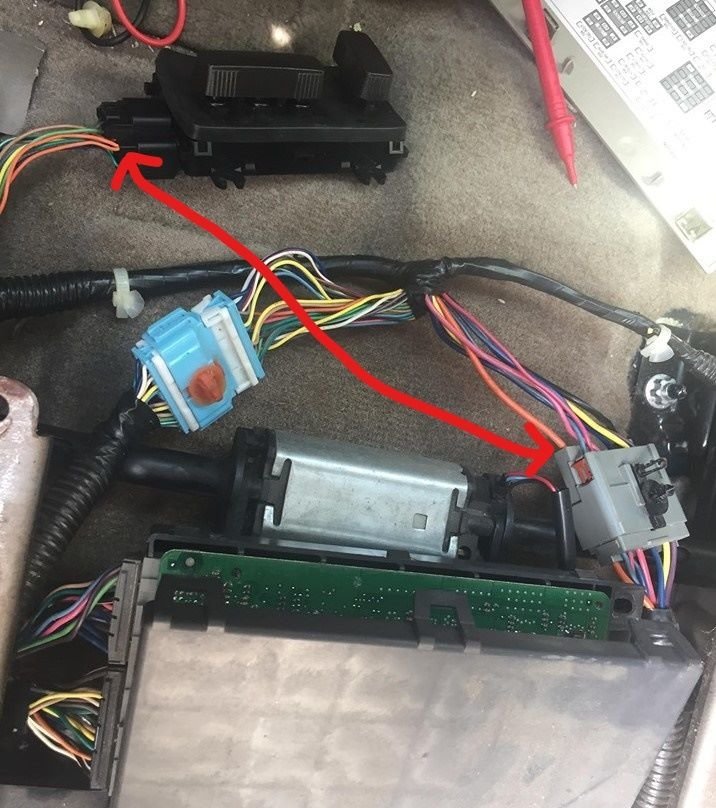

KEN LUDDEN
By not working I mean no movement for either the direction switch or the lumbar switch. However, the memory mode selection switch 1 - 2 does work and the seat changes position between the two. Also, the seat heater works. The passenger seat works fine. I've already replaced the switch, checked the fuses, and cleaned the contacts on the control module under the seat.
Update: I've made some progress. The image attached shows that if I run a jumper between these two points the seat works. The main harness orange wire carries 12.4 volts, but the orange wire voltage is only 11.5 at the switch. Any insight on what the problem may be?
KEN LUDDEN
Image:
You have resistance in that wiring from these two points. It appears that is from the main connector to the switch? If you are getting lower voltage at the switch then I would just cut the orange wire between those two points and make your jumper wire permanent. If you want to confirm this you can disconnect those two wires and measure resistance but you pretty much have already confirmed it.
Normally we are giving instruction to do what you have already done so you have already figured this out. So again, I would just make your jumper wire permanent by cutting the wires and splicing on the new wire. Let me know if you need help with that.
Good work!
