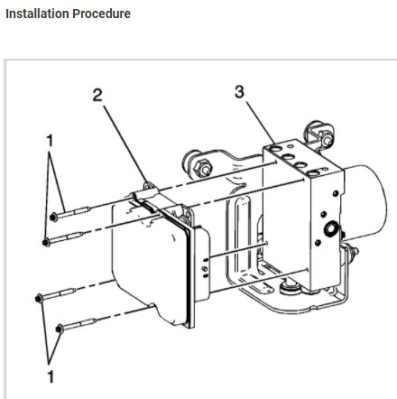

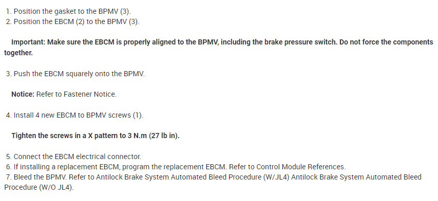

recently i have been experiencing the vehicle shaking when i break to a stop. the shaking seems to come from the front end of the tahoe. i think that the abs module is not working thank you.
Mar 5, 2009 at 3:37 AM
DANNY L
  • 5,648 POSTS
Hello, I'm Danny.

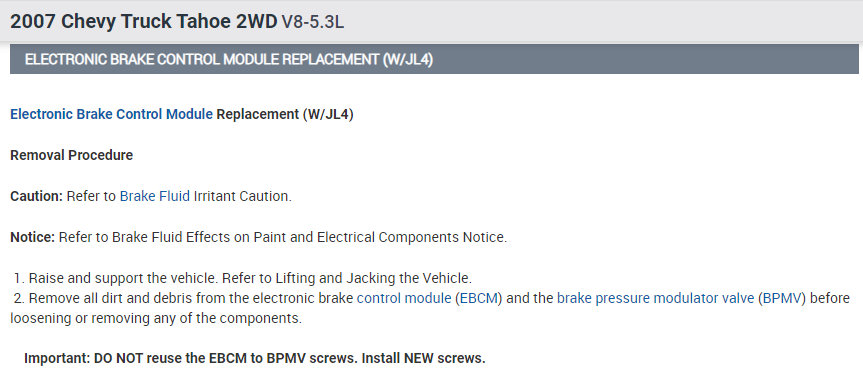

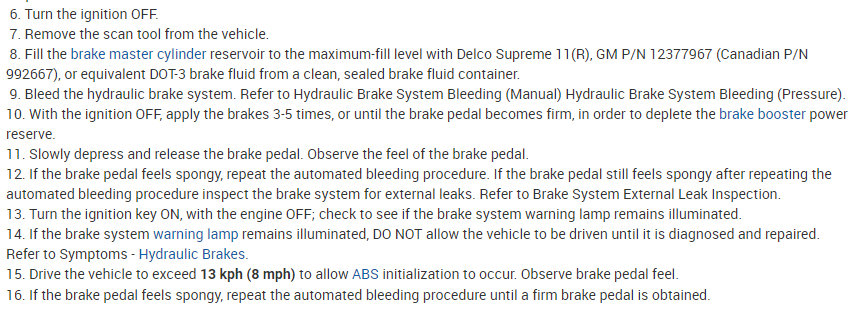

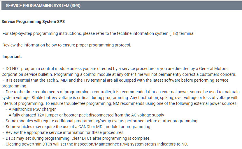

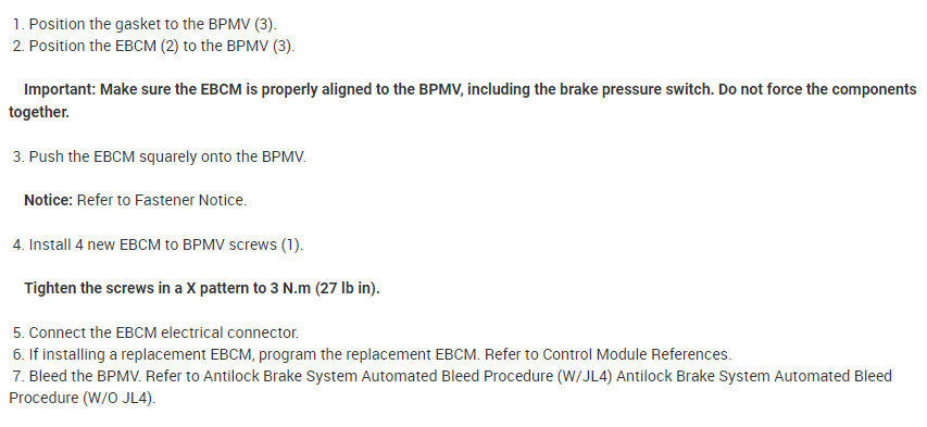

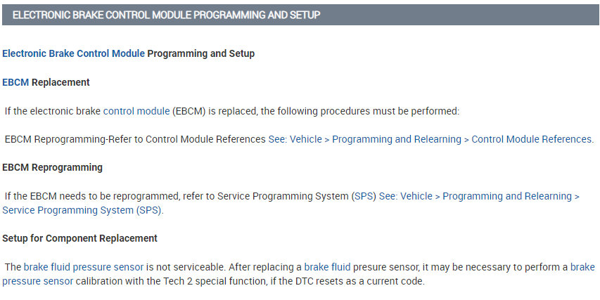

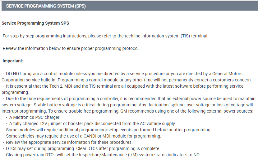

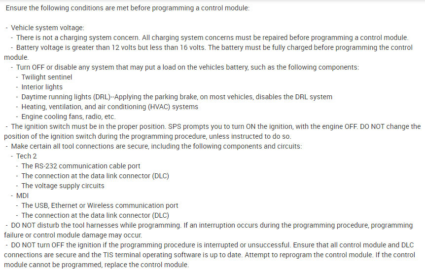

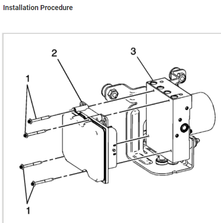

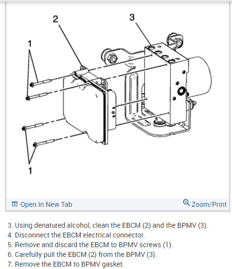

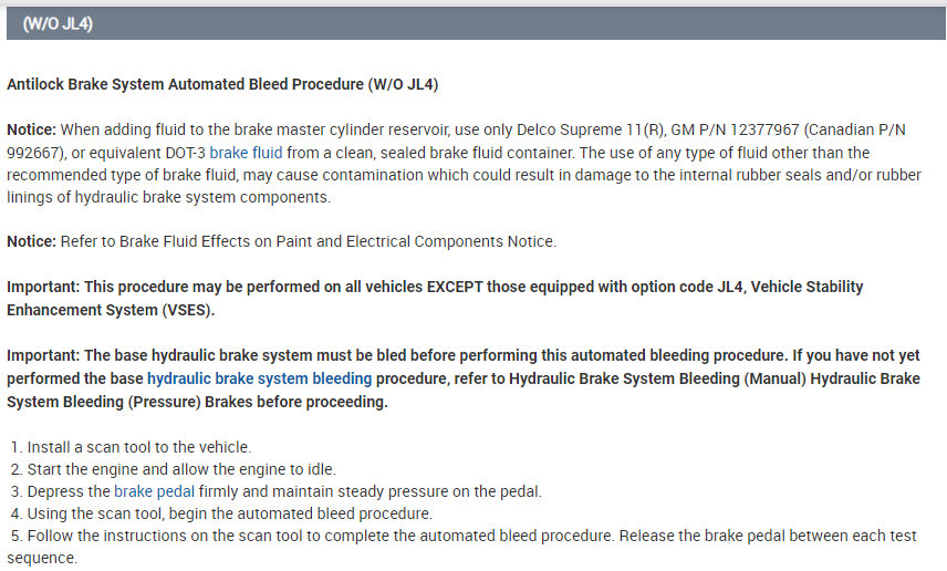

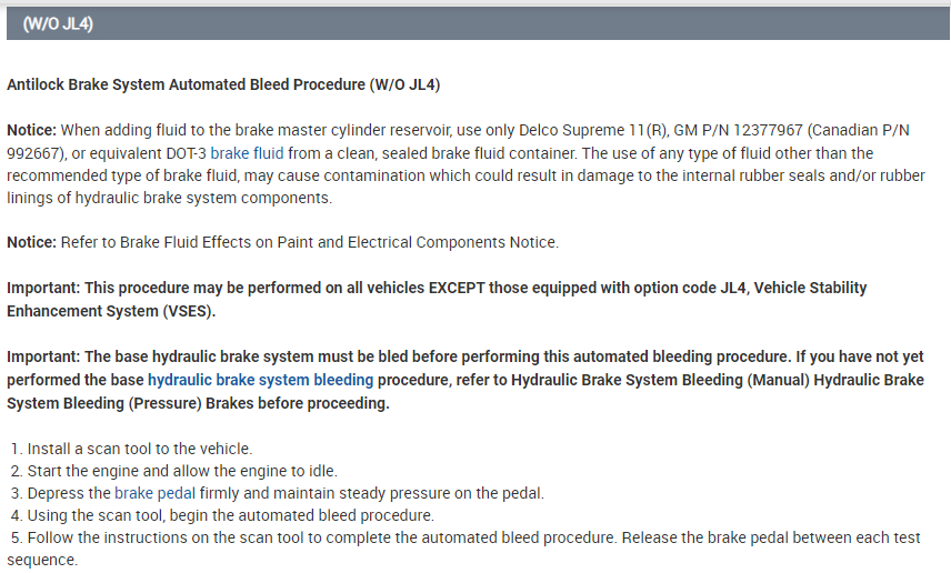

Here is the information you requested. After replacing the electronic brake control module you will need to perform 2 addition things. First is to perform a module relearn procedure after replacement and second is to perform an automatic ABS-anti-lock brake system bleed procedure. I've attached picture steps below on how to replace the module, perform the relearn process, and how to perform the automatic abs bleed procedure on your vehicle. This video will show you how
https://youtu.be/lUotkKXG9dY
