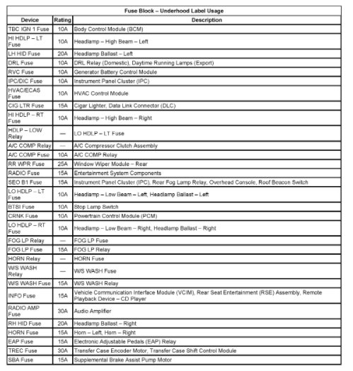

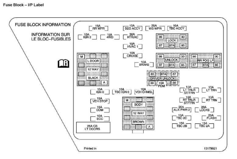

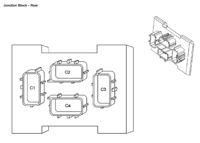

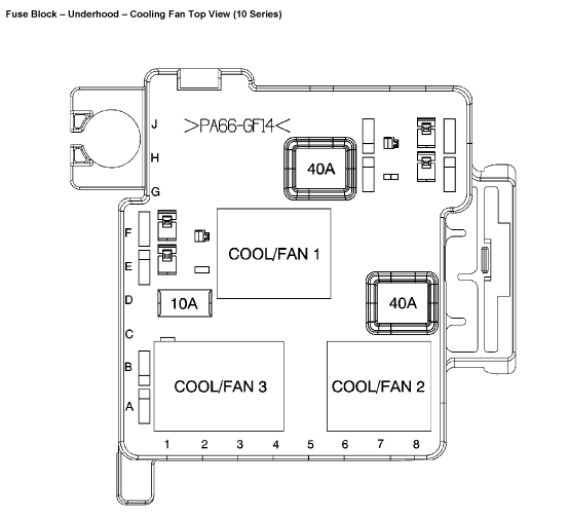

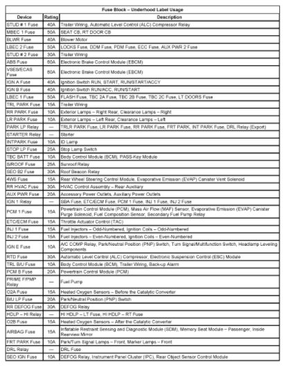

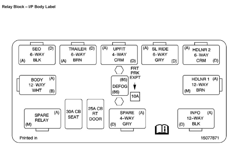

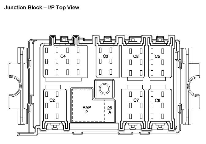

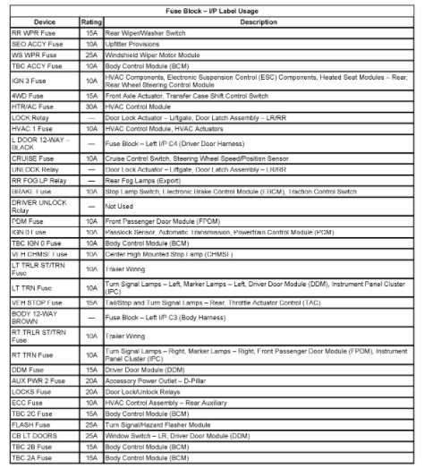

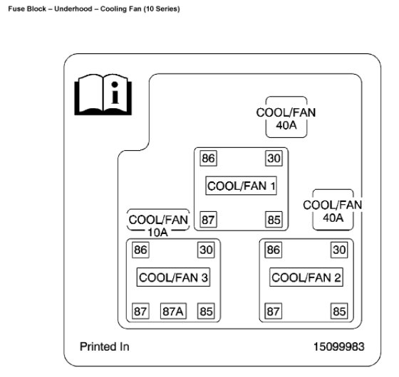

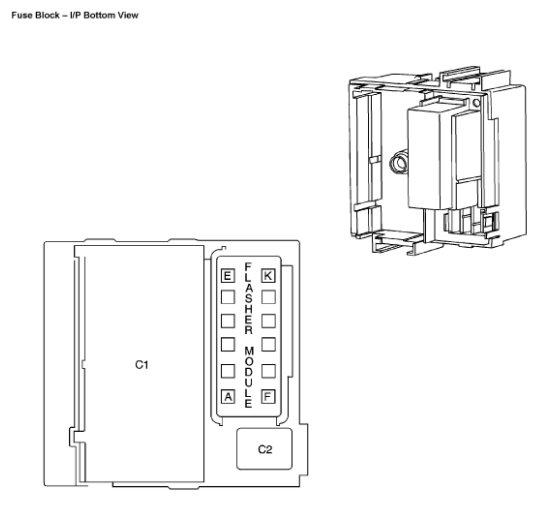

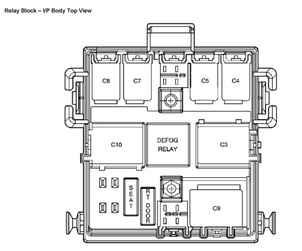

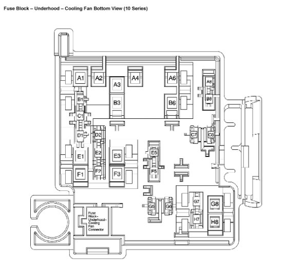

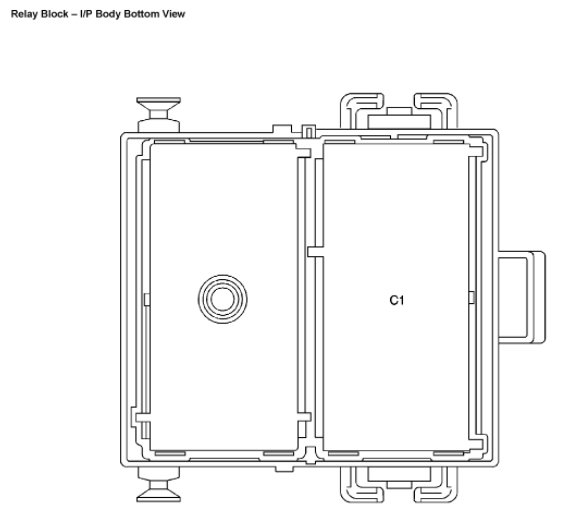

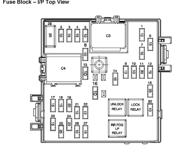

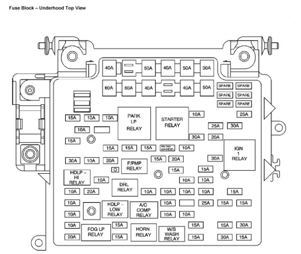

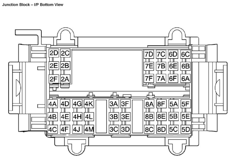

The rear passenger doors on my Tahoe will not lock via the remote, however they tell me I need to start by checking the fuses where are they and how do I check them?
Jul 19, 2010 at 9:01 AM
DANNY L
  • 5,648 POSTS
Hello, I'm Danny.
Here is the information you requested. Here are a few tutorials for you to view on how to check and replace fuses:

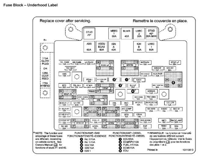

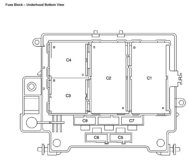

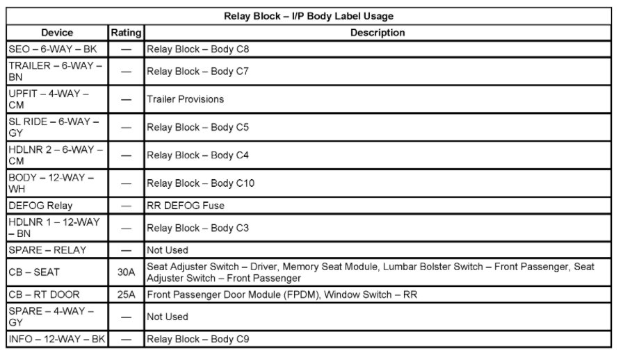

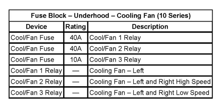

I've attached pictures below showing the fuse and relay locations on your Chevy Tahoe. Hope this helps and thanks for using 2CarPros.
