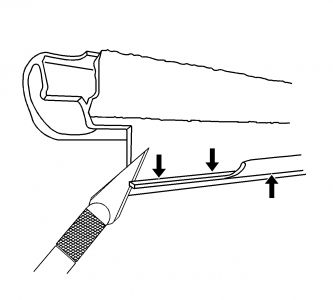

You can possibly pull the lower portion of the trim panel out enough to reach up in there and get to the bulb, otherwise the trim panel would need removed. The bulb may have come out of the socket and be floating around in the lamp housing. On the steering wheel controls, they are serviced only by replacement, and the proper way to do that is with the steering wheel removed. Try lubricating the window run channels with a dry silicone spray, You don't want to use anything that will leave a residue on the glass. There is a couple bulletins on windows, is it the front glass that is squealing, or the passenger rear? #PI0018: Front or Rear Side Door Window Binds, Moves Slowly, Makes Rattle/Squeak Noise, Poor Fit/Misalignment or Is Inoperative - (Jan 14, 2010) Subject: Front or Rear Side Door Window Binds, Moves Slowly, Makes Rattle/Squeak Noise, Poor Fit/Misalignment or Is Inoperative Models: 2008-2010 GM Passenger Cars and Light Duty Trucks (Including Saturn and Saab) The following diagnosis might be helpful if the vehicle exhibits the symptom(s) described in this PI. Condition/Concern Some customers may comment that the front or rear side door window has one or more of the following concerns: "¢ Window is inoperative/intermittent operation. "¢ Window rattles or squeaks. "¢ Window binds. "¢ Window has slow operation. "¢ Window fits poorly or is misaligned. Recommendations/Instructions Review each "Symptom" title below for proper diagnostics. The checks to be performed in each step MUST be completed. Note: The following is a general information guide to common issues that may occur with window regulators. ALWAYS be sure to search SI for additional information on specific window regulator concerns. Window is Inoperative/Intermittent Operation "¢ For 2-pin motors, first disconnect the motor connector and then apply a 12-volt power supply to the regulator motor to verify motor functions/activates. (This step is not possible on 6 or 7-pin motors.) "¢ Check the wire harness for pinched/shorted wires. Check the switch for correct function and check the switch bezel for sticking switches (Note: if the motor activates and stops, check for window/regulator binding/alignment per below.) "¢ Check for proper glass alignment/attachment. Position the window to access the side door window regulator window attach bolts. Loosen the two bolts that attach the window to the window regulator or disengage the glass from the snap fit attachment. Slide the window up and down in the run channel. Does the glass bind? If it does not bind, properly adjust - DO NOT replace the regulator. If it does bind, perform the checks below - DO NOT replace the regulator. "¢ Check for defective seal and/or proper seal installation. "¢ Check for debris in the glass run channel. "¢ Check for glass run channel position. Regulator/Glass Rattles "¢ Check for any loose fasteners and re-torque to specification as required. "¢ Check that the glass is in the channel and reinstall if not positioned correctly. Noisy Operation "¢ Check for other components in the glass path, such as wire harness, impact foam, lock rods or cables. "¢ Check for proper glass alignment/attachment and door seal installation. Windnoise/Water Leak "¢ Check seals, mirror patch and glass alignment. "¢ Check door alignment. False Glass Reversal/Glass Lowers Unexpectedly "¢ Check seals, re-initialize the window regulator and/or realign the glass. "¢ Check for debris in the glass run channel. Slow Operation "¢ Check for debris in the glass run channel. "¢ Lubricate the window regulator, if required, with GM Synthetic Multi-Purpose Lubricant w/PTF. Glass Does Not Index "¢ Check seals, re-initialize the window regulator and/or realign the glass. "¢ Check the switch for correct function and check the switch bezel for sticking switches. #05-08-64-032A: Rear Door Glass Squeal Noise When Rolling Down (Remove Material) - (Jan 30, 2008) Subject: Rear Door Glass Squeal Noise When Rolling Down (Remove Material) Models: 2004-2006 Cadillac Escalade 2004-2006 Chevrolet Tahoe 2004-2006 GMC Denali, Yukon This bulletin is being revised to change the Warranty Information. Please discard Corporate Bulletin Number 05-08-64-032 (Section 08 -- Body and Accessories). Condition Some customers may comment that the rear door glass squeals when rolling down. Cause The lower lip on the outer belt sealing strip folds over, exposing the non-flocked side of the strip to the glass. Correction Remove the outer belt sealing strip following SI Document ID# 757236.
https://images.2carpros.com/forum/automotive_pictures/309872_1709832_1.jpg
Using an X-ACTO ® knife, remove the lower lip the full length of the strip. Refer to the illustration above. Install the outer belt sealing strip following SI Document ID# 757236. Warranty Information
