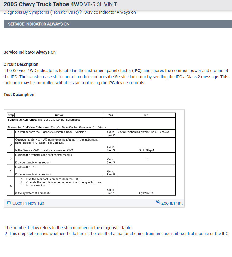

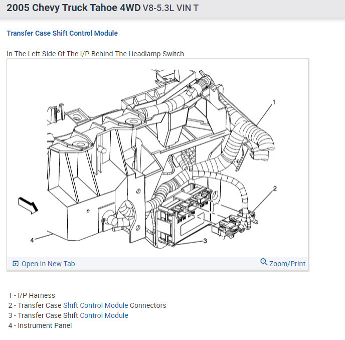

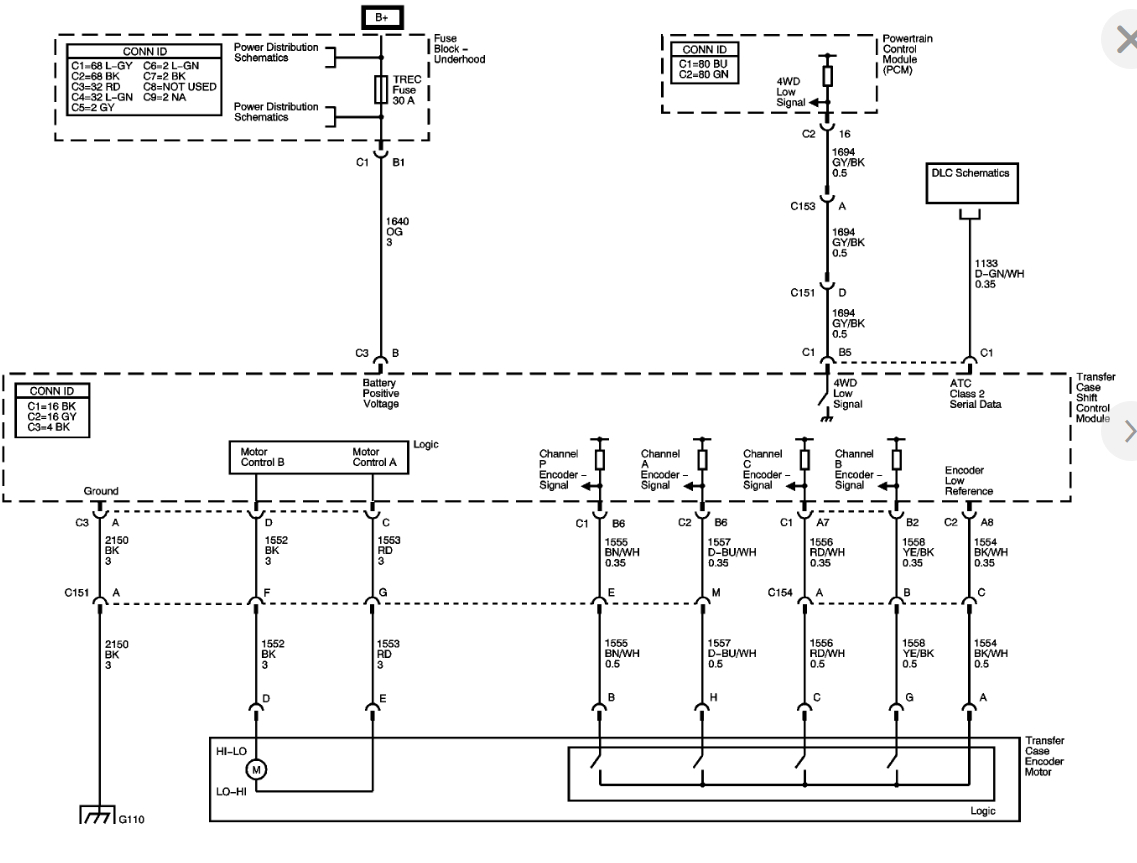

Can you show me how to fix the 4wd light?
Aug 10, 2009 at 2:52 PM
SQM
  • 6,383 POSTS

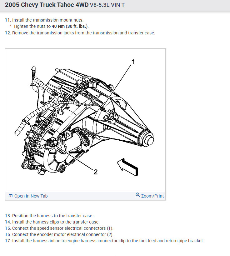

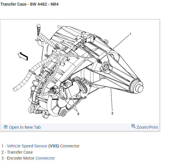

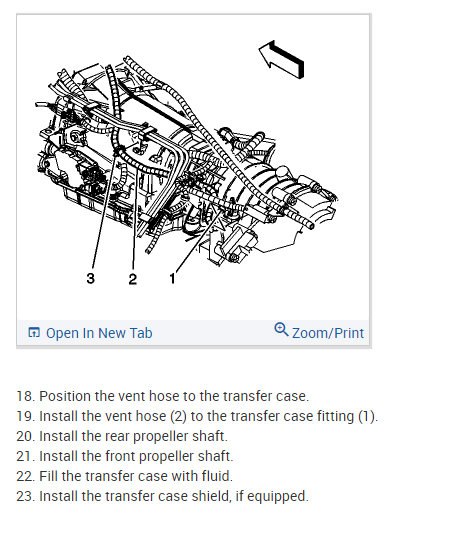

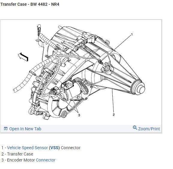

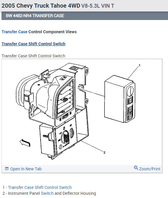

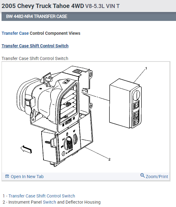

The 4WD error light can be illuminated when the system detects a fault within the four-wheel drive system.
It can be due to few different reasons.
It can be a faulty transfer case shift module, bad switch, inoperative transfer case, it can also be due to a wiring issue.

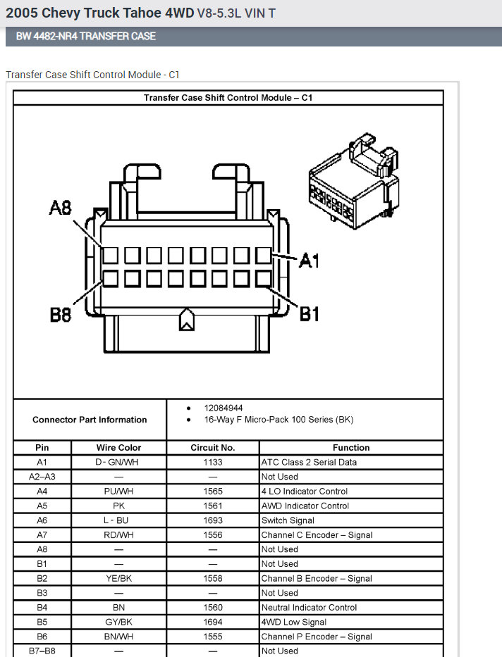

I have included the wiring schematics for your reference.

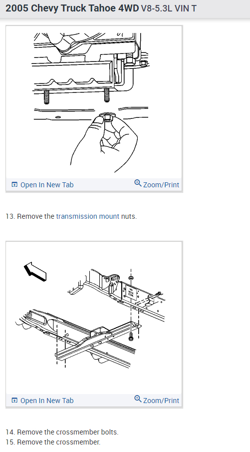

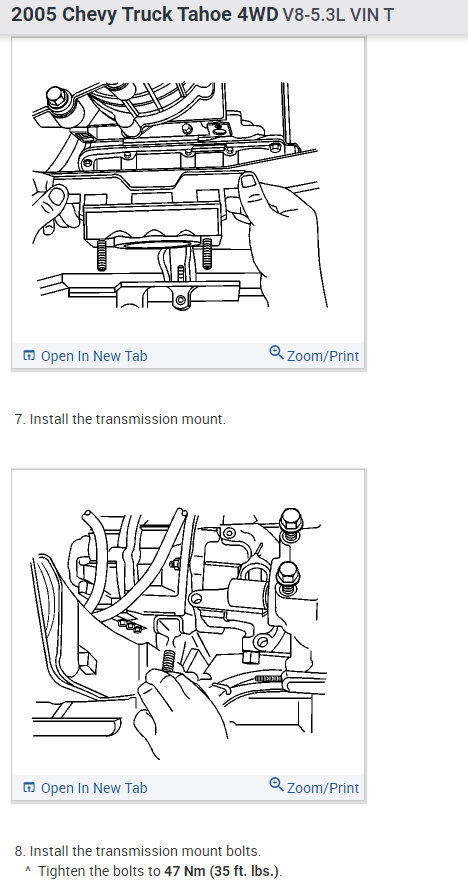

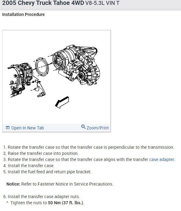

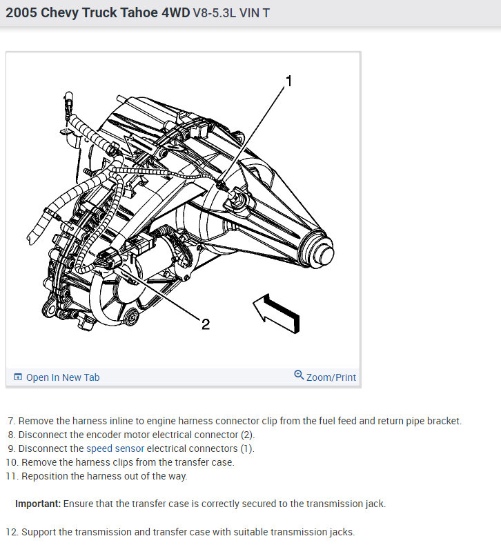

I have attached the diagnostics steps for the 4WD error light (look below).
