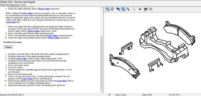

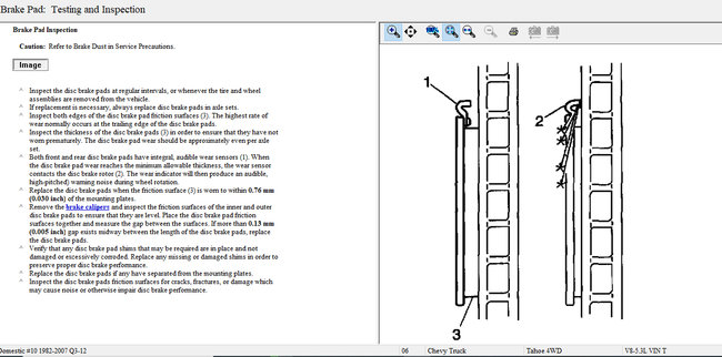

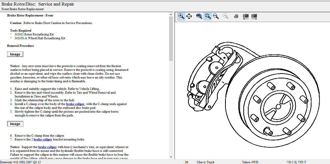

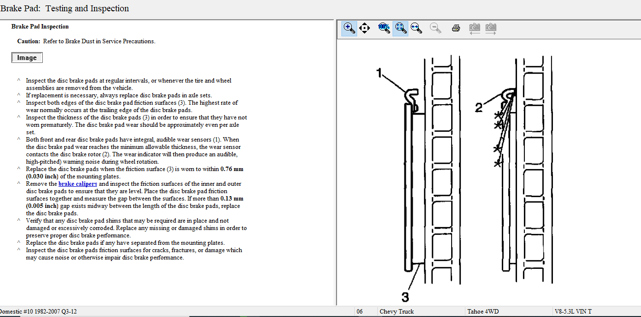

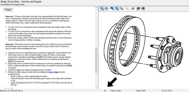

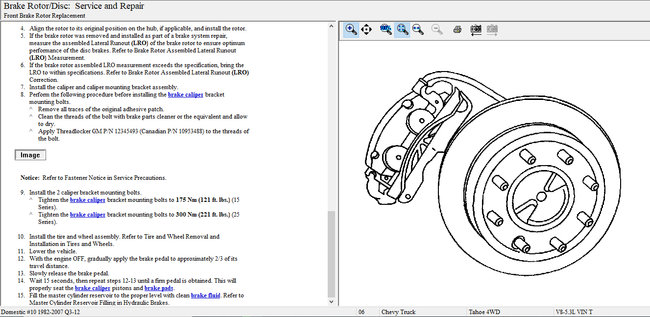

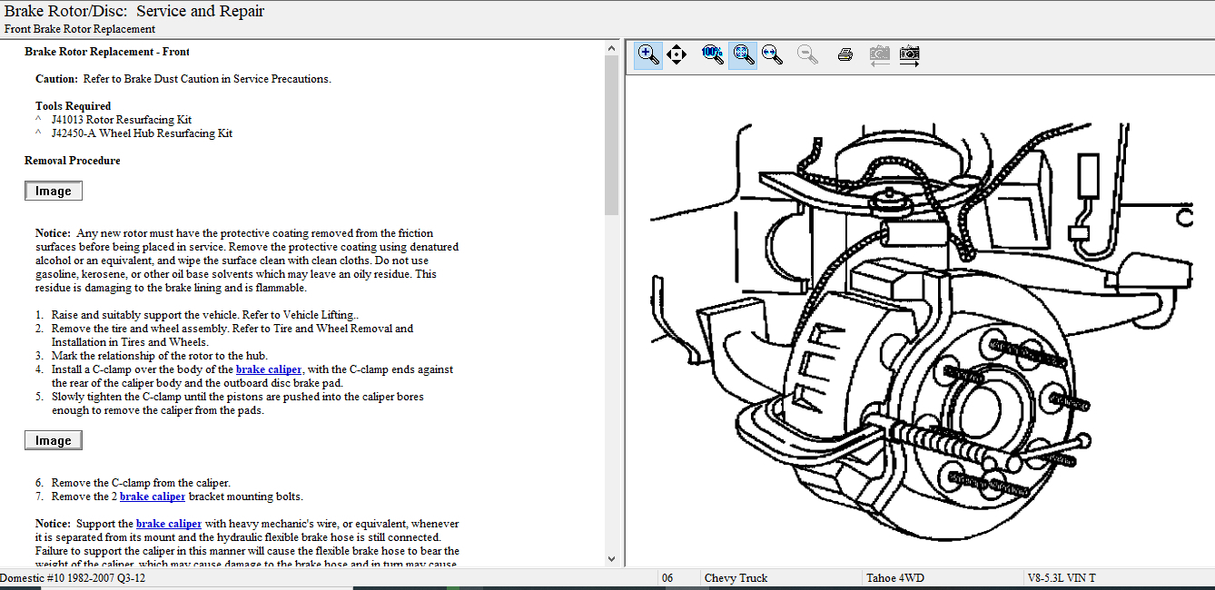

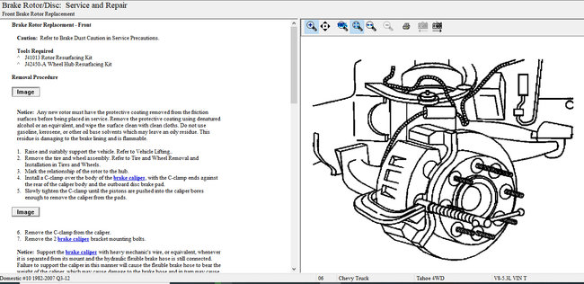

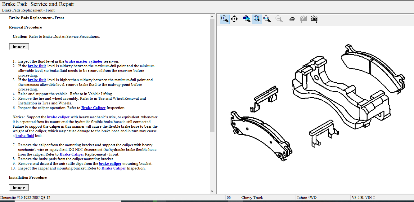

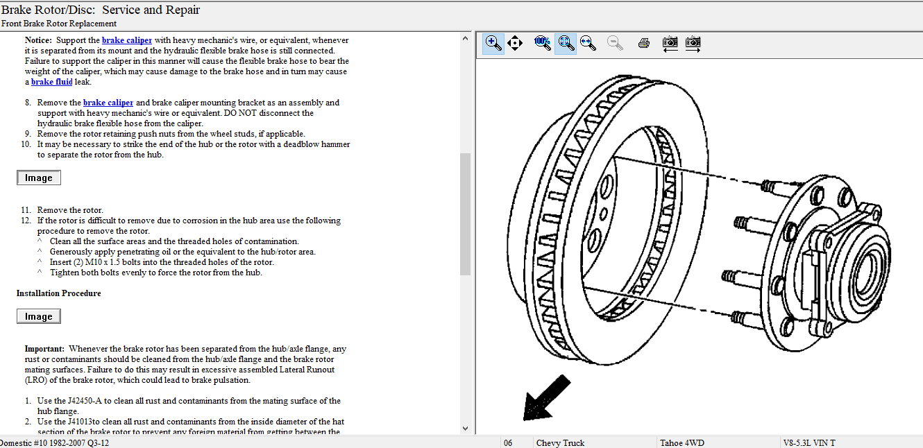

Hello.
Check our guide below how to replace front brake pads and discs.
Check the diagrams below how to replace front rotors and pads.
let us know if you need more help.
thank you.
