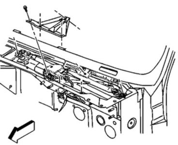

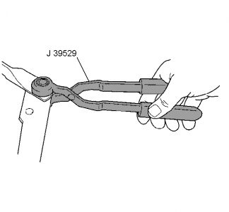

how do you replace windshield wiper motor for 2004 tahoe. is the passenger side. i am not an experienced do it yourself car repair but have done minor repairs, oil change, etc. grw up on a farm so know how to use tools. thank you

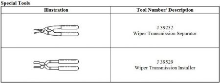

WIPER MOTOR REPLACEMENT TOOLS REQUIRED

REMOVAL PROCEDURE
https://images.2carpros.com/forum/automotive_pictures/12900_wa_1.jpg

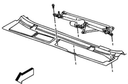

1.Remove the wiper arms. 2.Remove the air inlet grille panel. 3.Remove the 4 bolts and the reinforcement panel.
https://images.2carpros.com/forum/automotive_pictures/12900_wm_1.jpg

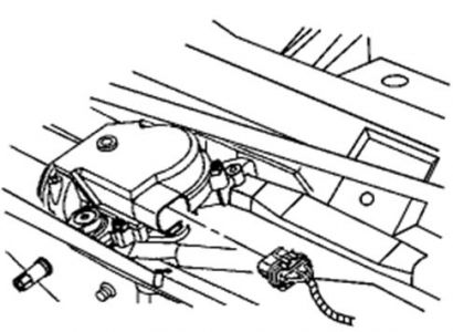

4.Disconnect the electrical connector from the wiper motor.
https://images.2carpros.com/forum/automotive_pictures/12900_w_1.jpg
5.Remove the 2 bolts from the wiper transmission assembly. 6.Remove the wiper transmission assembly from the vehicle.
https://images.2carpros.com/forum/automotive_pictures/12900_jt_1.jpg

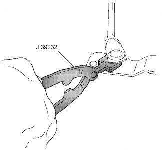

7.Remove the drive link from the wiper motor crank arm with the J 39232.
https://images.2carpros.com/forum/automotive_pictures/12900_mw_1.jpg

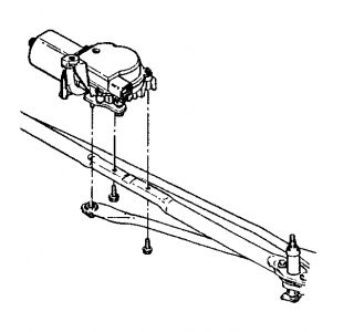

8.Remove the 2 bolts retaining the wiper motor. 9.Remove the wiper motor from the wiper transmission assembly. INSTALLATION PROCEDURE 1.Install the wiper motor onto the wiper transmission assembly with the 2 bolts. NOTE: Refer to Fastener Notice in Service Precautions. Tighten the 2 bolts to 8 N.m (71 lb in).
https://images.2carpros.com/forum/automotive_pictures/12900_jt1_1.jpg
2.Install the drive link onto the wiper motor crank arm with the J 39529. 3.Install the wiper transmission assembly on the vehicle with the 2 bolts. Tighten the 2 bolts to 9 N.m (80 lb in). 4.Connect the electrical connector to the wiper motor. 5.Install the reinforcement panel with the 4 bolts. Tighten the 4 bolts to 9 N.m (80 lb in). 6.Install the air inlet grille panel. 7.Install the wiper arms. 8.Operate the wipers and check for proper operation.
