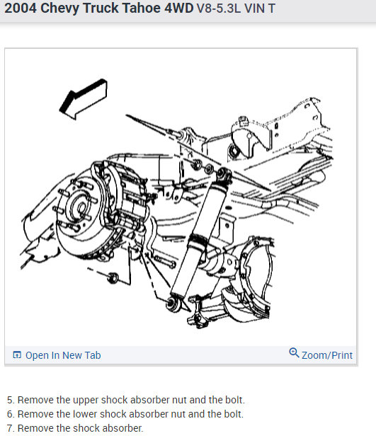

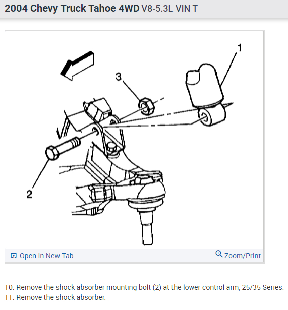

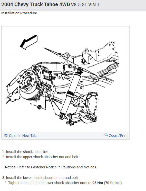

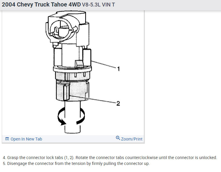

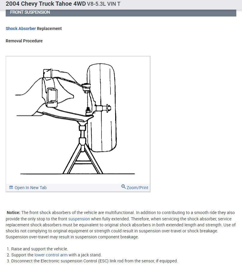

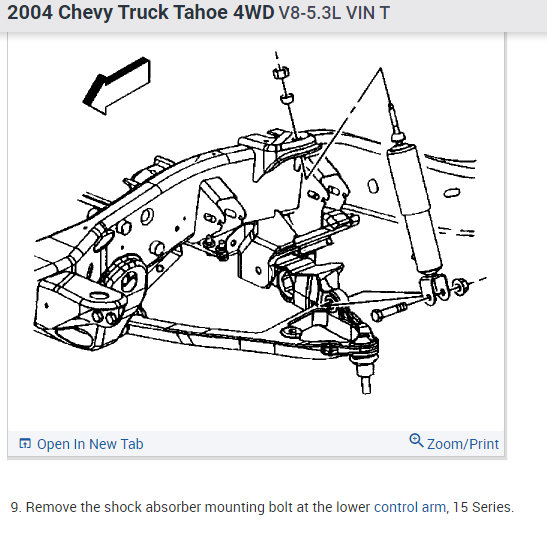

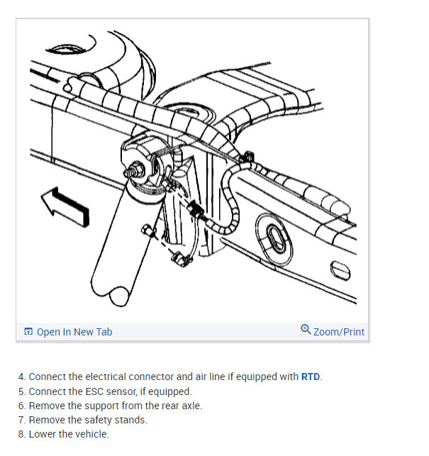

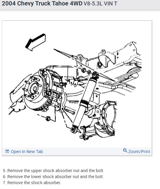

does this site have and video on how to change shocks/suspenion on trucks
Mar 13, 2009 at 12:30 PM
SQM
  • 6,383 POSTS

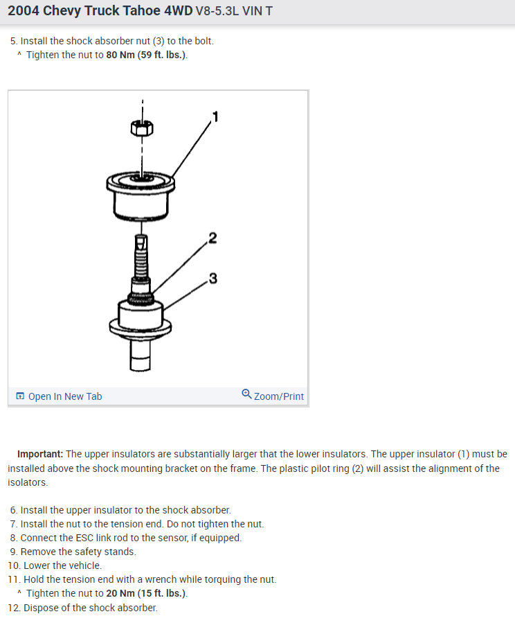

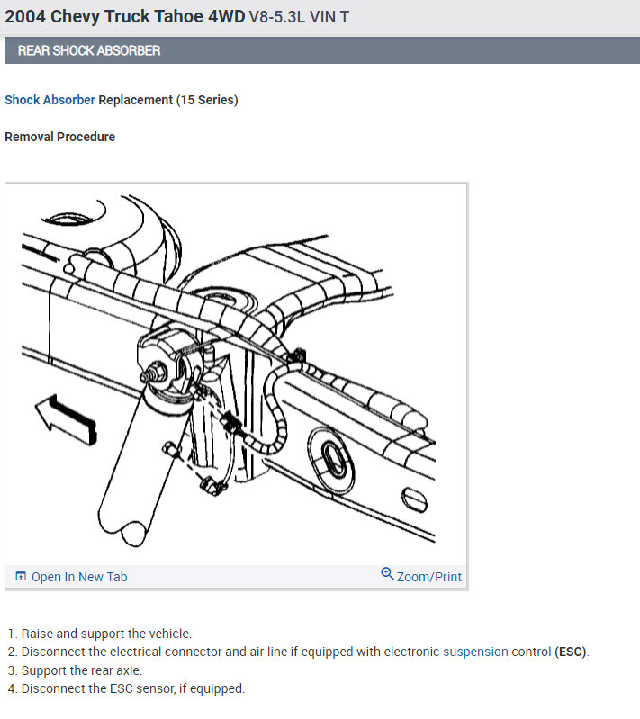

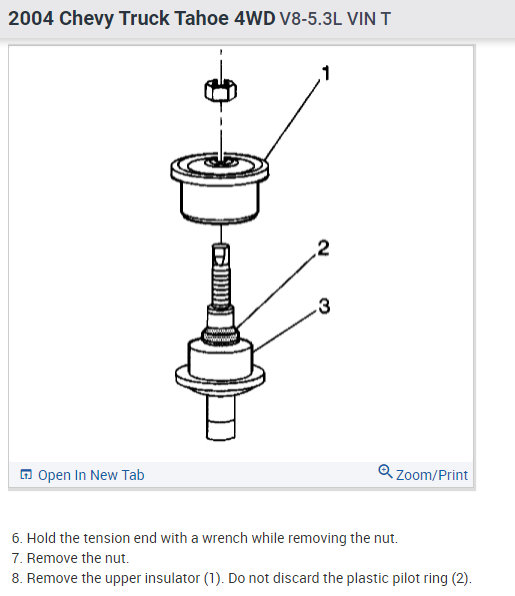

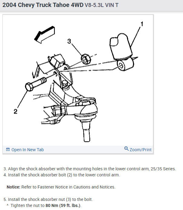

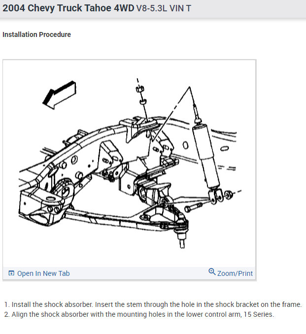

Here is a video that shows shock replacement on a Silverado, it might be a little different than your Tahoe but does have the same basic principle.
https://youtu.be/kARndh2qpgs
https://www.2carpros.com/articles/replace-shock-absorber

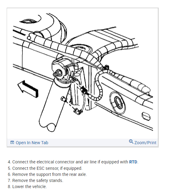

I have attached the replacement procedure for the front and rear shocks (look below).
