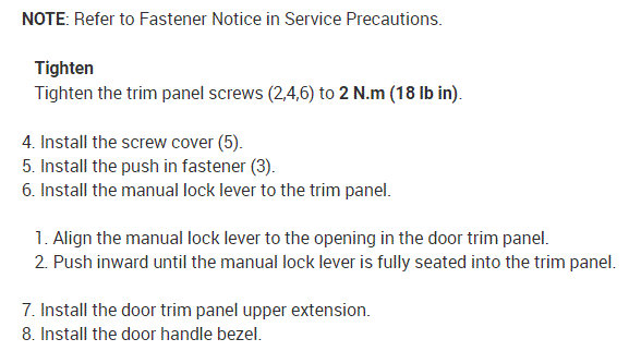

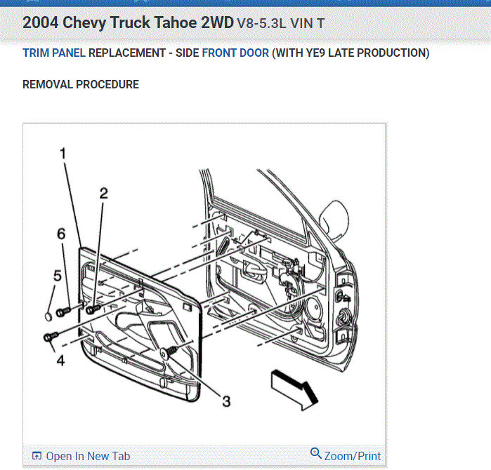

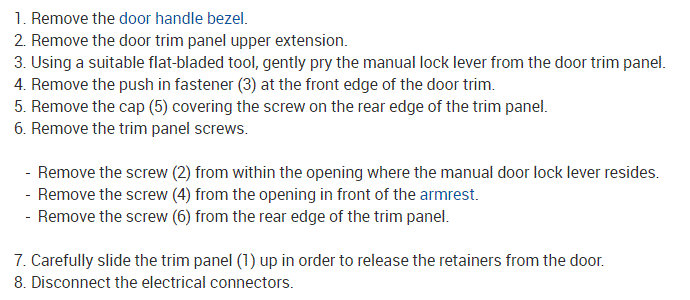

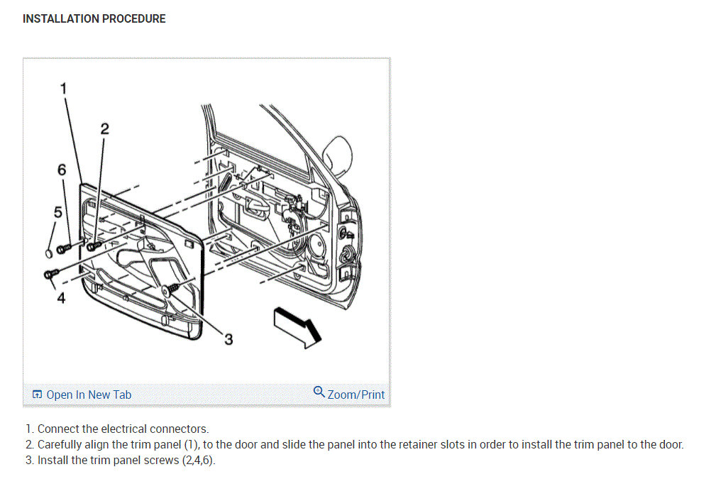

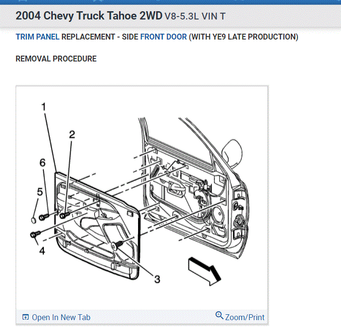

The chime comes through the affected speaker, so that makes sense that you wouldn't hear it. Have you removed the door panel to inspect the wiring to the speaker to make sure nothing is disconnected or shorted?
I attached the directions for the removal of the door panel. This is where I would suggest starting. Remove the panel and confirm there is nothing disconnected or damaged as far as the wiring is concerned.
