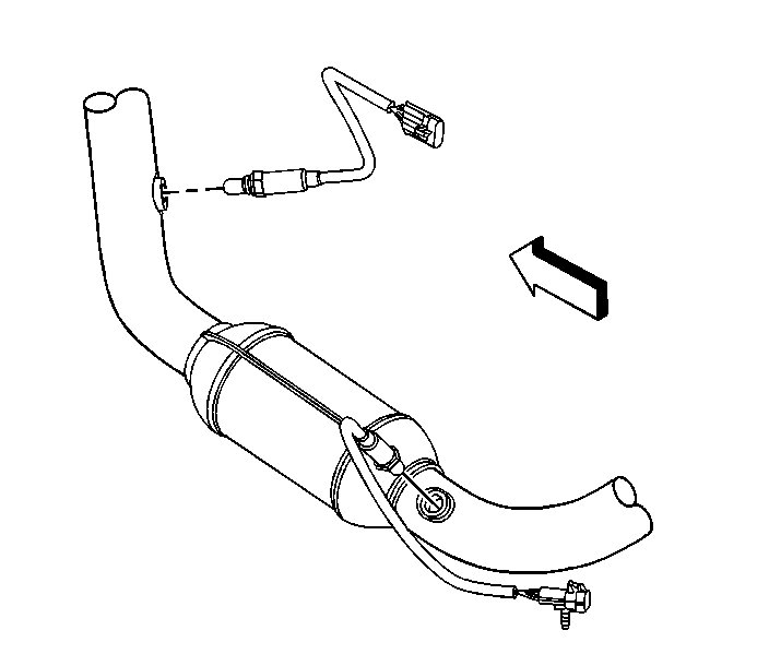

Check engine light came on, had vehicle scanned and the Downstream O2 sensor came up as bad. Purchased a Bosch O2 sensor and replaced sensor that was before the catalytic converter. Which is is which? I need to do the repair myself to save money.
Feb 18, 2010 at 1:25 AM
  • 110,244 POSTS

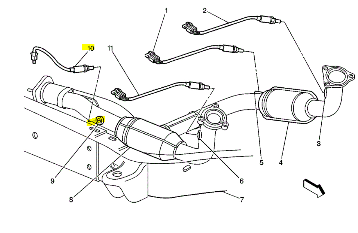

The down stream sensor is after the catalytic converter. If you look at the attached pic, I highlighted where it goes. If you look at the picture, bank 1 sensor 1 goes where number 3 is pointing and pic 6 shows bank 2 sensor 1.

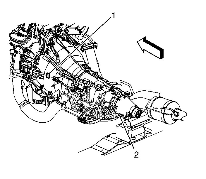

REMOVAL PROCEDURE
pic 2
1. Raise and suitably support the vehicle. Refer to Vehicle Lifting.
2. If equipped, disconnect the fuel composition sensor electrical connector.
3. Disconnect the connector position assurance (CPA) retainer.
NOTE: Refer to Heated Oxygen and Oxygen Sensor Notice in Service Precautions.
4. If equipped with a fuel composition sensor, remove the heated oxygen sensor (HO2S) electrical connector from the fuel line clip.
5. If equipped with a 4.8L or 5.3L engine, disconnect the HO2S electrical connector (2).

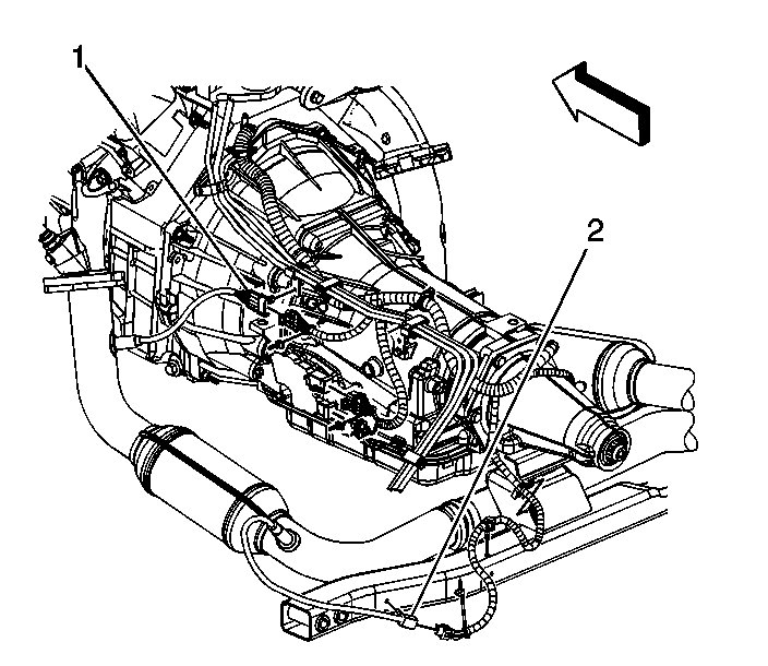

pic 3
6. If equipped with a 6.0L engine, disconnect the HO2S electrical connector (2).
pic 4
7. Remove the HO2S.
NOTE: Refer to Excessive Force and Oxygen Sensor Notice in Service Precautions.
