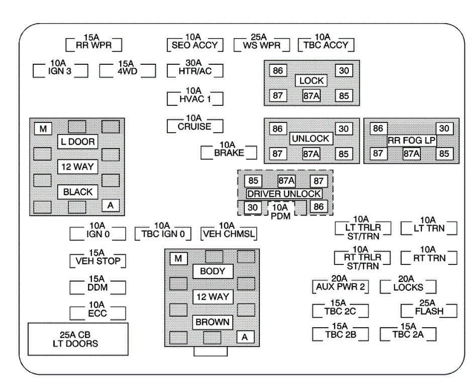

my front door passenger mirror side will not work, but the drivers mirror does not. I need to check the fuses where are they?
Mar 24, 2008 at 4:09 AM
  • 110,244 POSTS

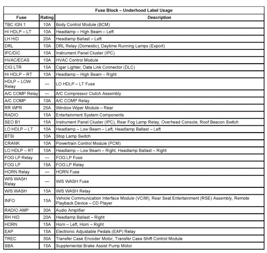

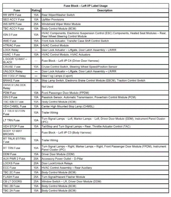

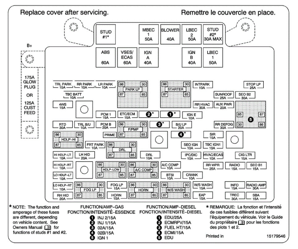

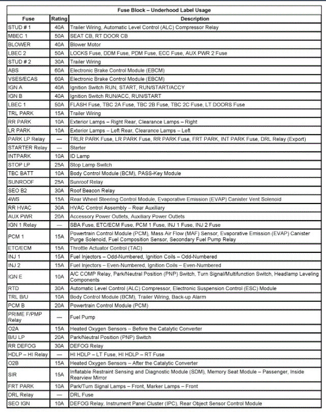

If you look below, I attached the fuse information requested. The first fuse box listed is under the hood. The second is in the vehicle. The legends follow the fuse box pictures.
When you check a fuse, not only should the fuse be checked, but also power to and from the fuse should be checked.
