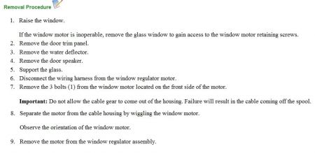

how do i replace an electric window motor

https://images.2carpros.com/forum/automotive_pictures/261618_Noname_2540.jpg

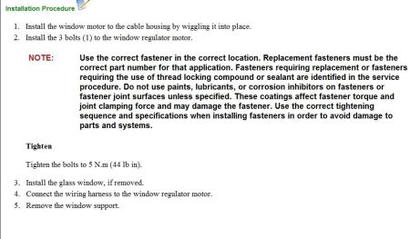

https://images.2carpros.com/forum/automotive_pictures/261618_Noname2_826.jpg
