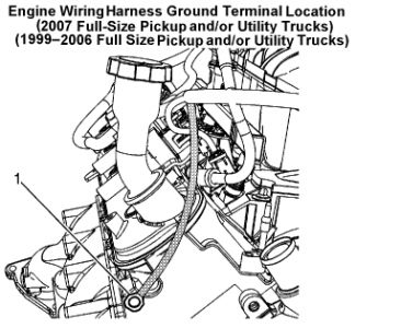

I originally had code P0420 catalyst efficiency code which only set off the check engine light during the winter months then all summer it would be fine. I read that it could possibly be the coolant temperature sensor which could cause the computer to read the CC emissions when the engine wasn't warm. I replaced both bank 1 O2 sensors and the coolant temperature sensor then reset the codes. Then I started getting P0171 bank 1 is running too lean code. I checked for vacuum leaks (there weren't any) and cleaned the MAF sensor which then turned the light off. Now I'm trying to get it to pass inspection and after driving it for 200 miles (after reseting codes) the drive cycle still hasn't tripped the catalyst sensor or evaporative system. Any idea on what the cycle for those sensors is for my year, make, and model? Could this be a result of a lose connection?

on the cat and evap system sometimes the drive cycle is 300 miles or more because it takes longer for these vehicles to run an evap and cat test.plus if you have a p0420(which means you usually replace the cat)when it runs the test on the cat if there is a problem inside it will reset p0420.also a malfunctioning cat will cause a p0171.check this ground firstmake sure its clean and tight,if it is you might be replacing the cat converter.
https://images.2carpros.com/forum/automotive_pictures/147643_ground_1.jpg
post back with what you find.

Cleaned and tightened the wire you suggested (only one end couldn't reach the other end without removing a bunch of stuff). It was already pretty tight though and relatively clean.
The evap system and catalytic system are still reading "not ready" so I'm not sure if anything is fixed yet. Went to the dealership and he said it should have read after 50 or so miles.
