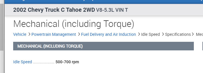

When I come to a complete stop the engine idles to 500 rpm and then picks up once I move. Is 500 rpm normal for an idle stop?
Sunday, April 18th, 2010 AT 7:55 PM
MECHANIC
18,907 POSTS
The idle on this vehicle is controlled by the PCM and uses the idle air control valve to achieve that.
https://www.2carpros.com/articles/how-to-replace-an-idle-speed-control-motor-iac
Assuming that the idle does not bounce or surge when at a stop then 500 RPMs is just fine.
I am attaching the spec below which will show this.
Let us know if you have more questions. Thanks
