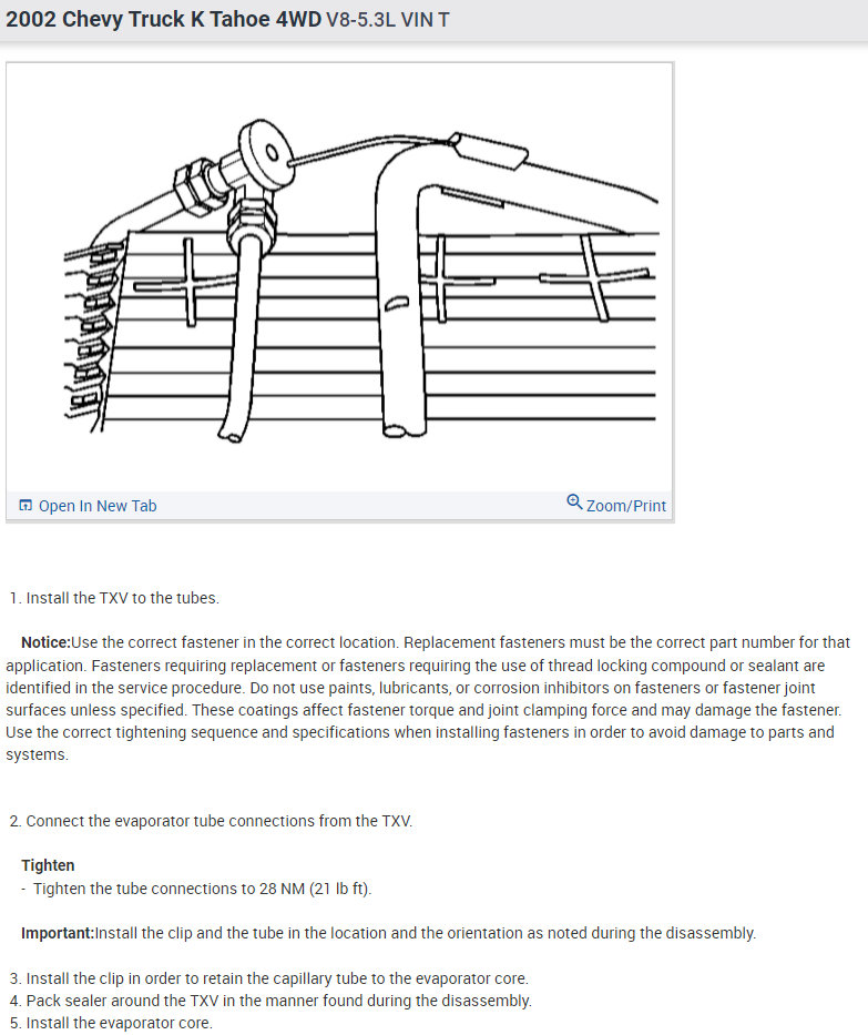

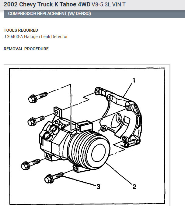

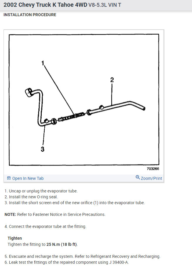

Last year the Rear A/C Unit stopped blowing cold air and now the Front side has also quit. I've been told its the compressor and along with that there are (2) valves and a few filters that need changed. Is this right and if so how much should it cost?
May 18, 2009 at 4:57 AM
SQM
  • 6,383 POSTS

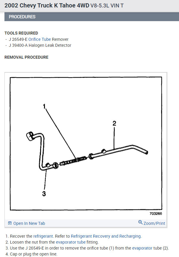

Any time the A/C compressor gets replaced, it is recommended to replace the receiver dryer, expansion valve and orifice tube. This will extend the life of the new compressor and give you the best performance.
Here are couple of helpful articles:
https://www.2carpros.com/articles/how-a-car-air-conditioner-works
https://www.2carpros.com/articles/replace-air-conditioner-compressor

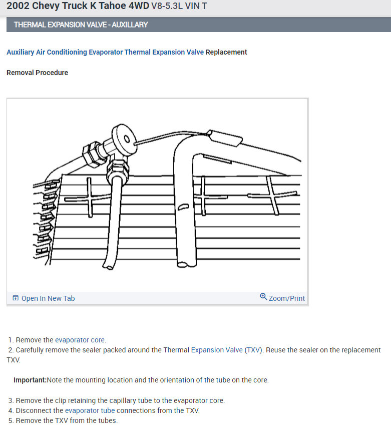

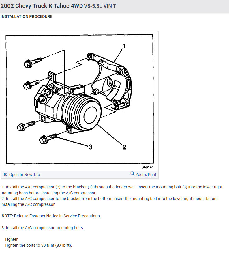

I have included the replacement procedures for your reference.
