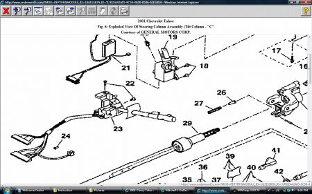

On an interstate drive, my low beam headlights stopped working and the high beam lights turned on by themselves. I'm taking apart the steering column because I smelt burning plastic and felt a lot of heat coming from there. How do I remove the tilt switch and the light selector switch from the steering column?

STEERING COLUMN SWITCHES -2001 Chevrolet Tahoe Page 1 of 1 Removal Ensure multifunction switch lever is in center position. Disconnect negative battery cable. Disable air bag system. Remove steering wheel. Remove knee bolster, if necessary. Remove bolts/screws and lower column cover. Remove bolts/screws and upper column cover. Remove lock cylinder, if necessary. Remove wiring harness strap. Disconnect steering column harness connectors. Disconnect multifunction switch Gray and Black connectors. Remove multifunction switch from vehicle.
https://images.2carpros.com/forum/automotive_pictures/62217_Multi_2.jpg
Once the column cover is off, just a couple of screws take it off.
