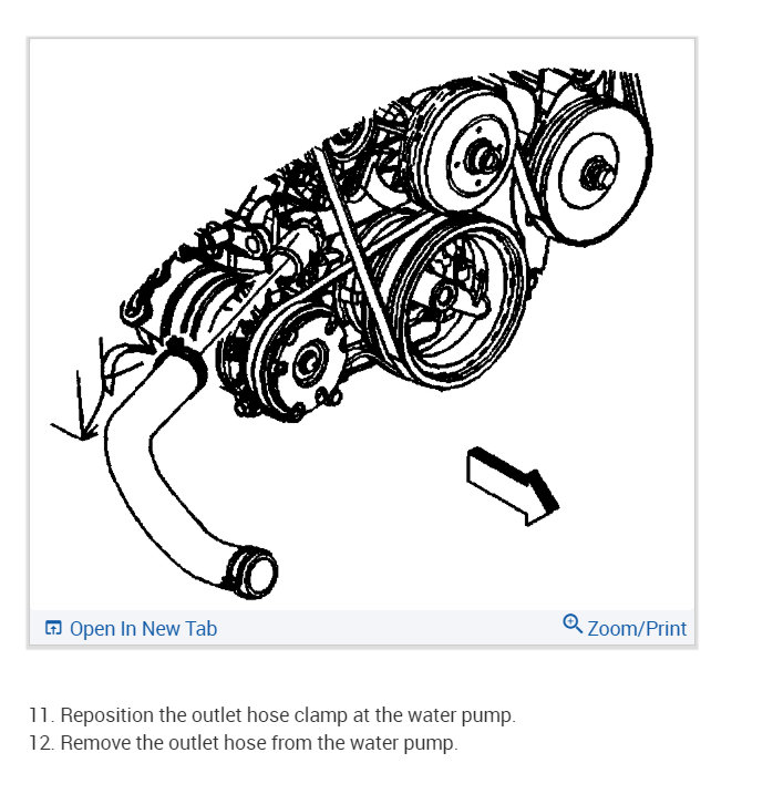

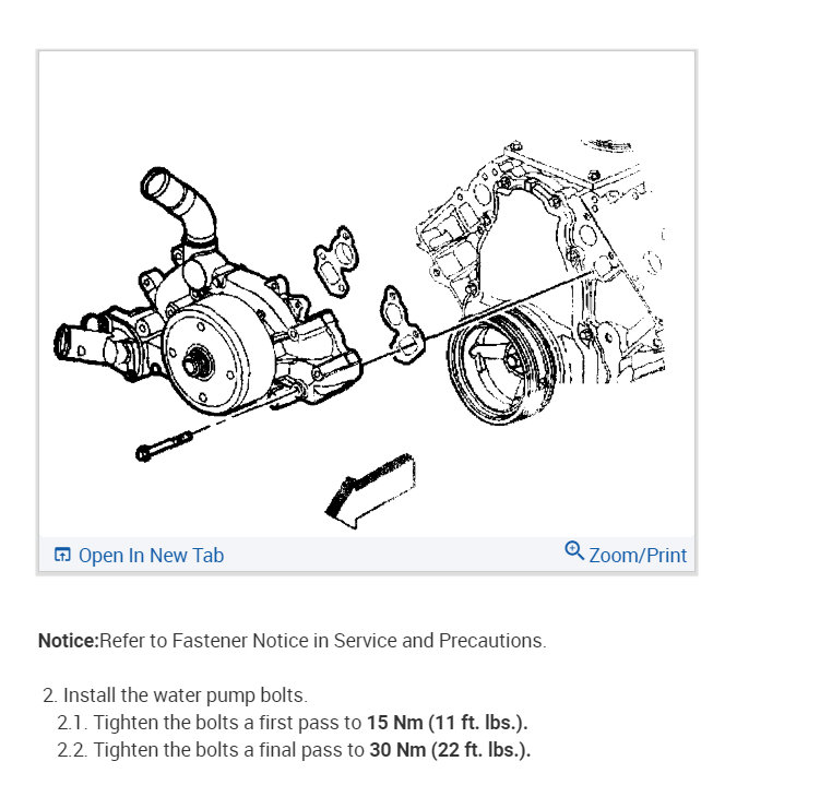

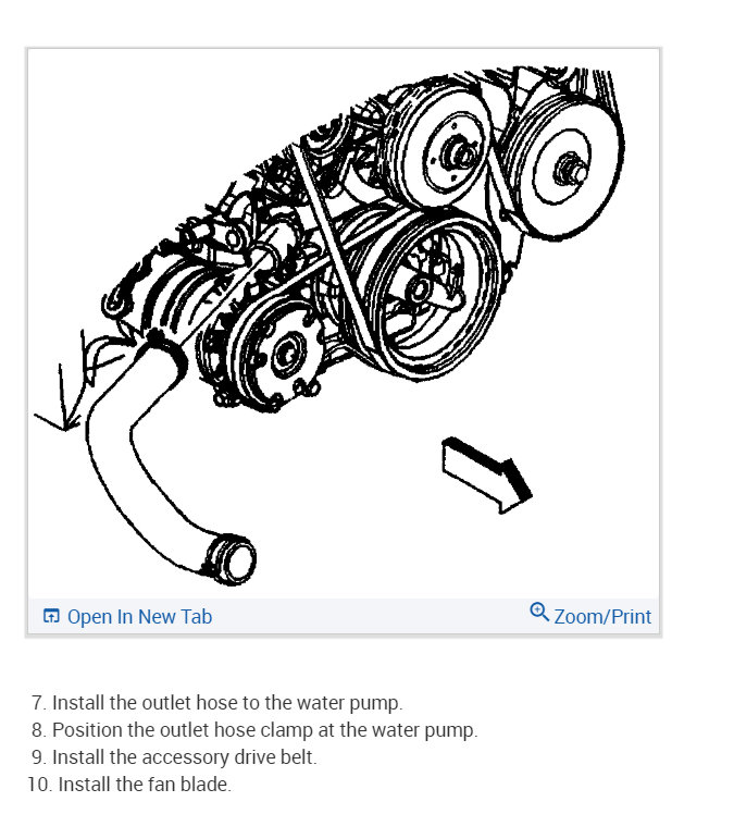

My Tahoe seems to have a leak and the liquid seems to be radiator fluid (it's red and it's not tranny fluid). The leak seems to be comming from the bottom front right corner of the engine (almost near the water pump, right below the water pump), it seems to be leaking from one of the screws. I'm guessing the gasket in that area is bad. However I cannot pin point exactly what that part of the engine is. It would be very helpful if I can find a diagram of 2006 Chevy Tahoe. If anyone can help I would appriciate it. I can also provide pictures if necessary.

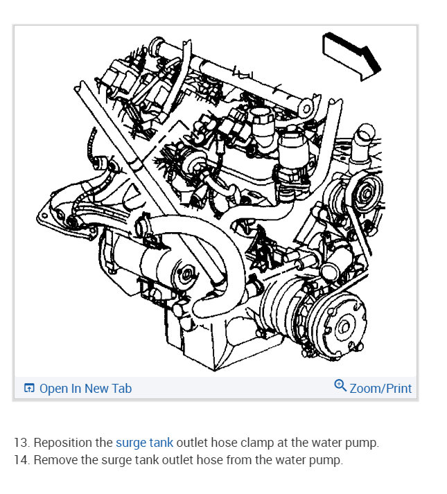

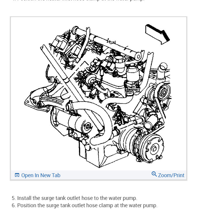

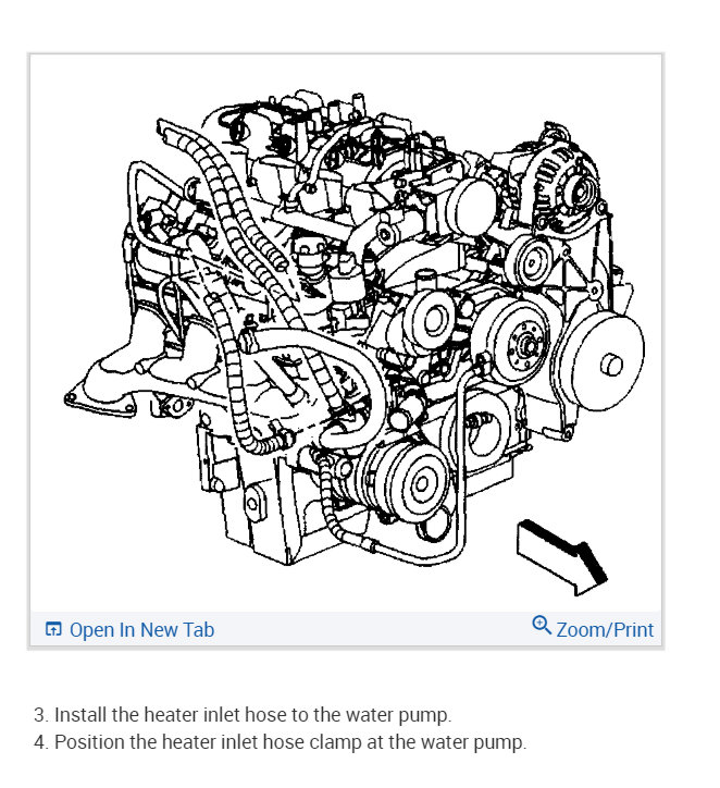

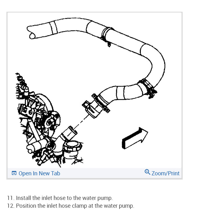

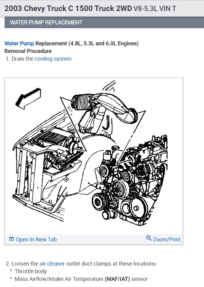

Hello

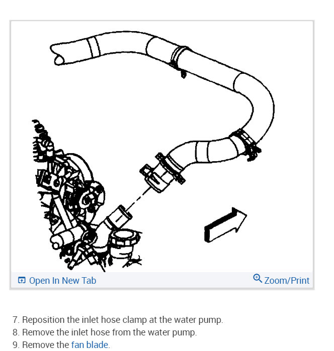

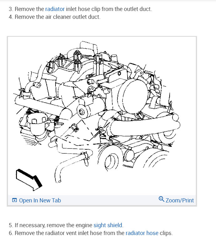

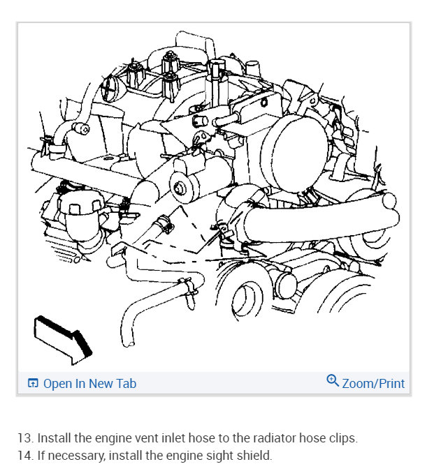

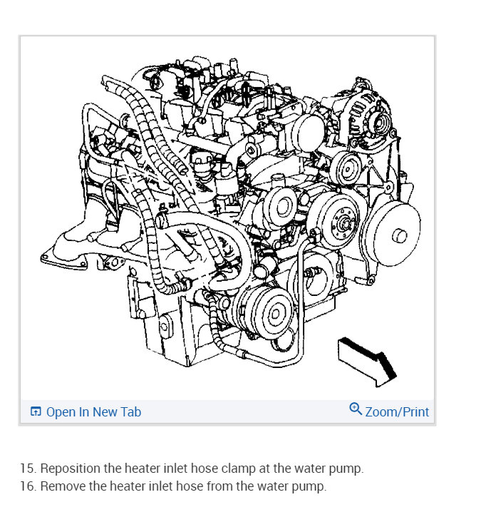

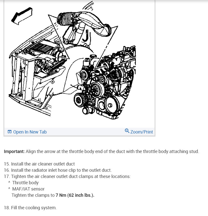

Here is a guide to help walk you through the steps with instructions in the diagrams below to show yo how on your car.
https://www.2carpros.com/articles/water-pump-replacement

the instructions are pretty lengthy and we can't copy them all, you are better of to get teh manual for your truck. this site has an online one available for minimal cost that you can print what you need.

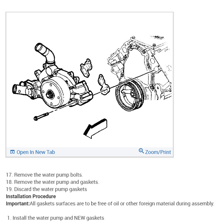

The pump is most likely leaking from the gaskets where it bolts to the engine. There are two special tools to remove the clutch, but you don't have to remove it to change the gaskets.

There is a round hole under the pump that is most likely leaking. Check for the leak there. If leaking, the pump's bearing is bad causing the seal to leak. This is what happens on almost all waterpumps when they go bad, and yes they could make a churping sound.
As far as labor, it should take no more than two hours.
