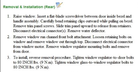

the passenger rear window came off the track and when I took off the panel the window regulator wires were loose. How do you repair or replace the window regulator?

https://images.2carpros.com/forum/automotive_pictures/261618_Noname_2356.jpg
