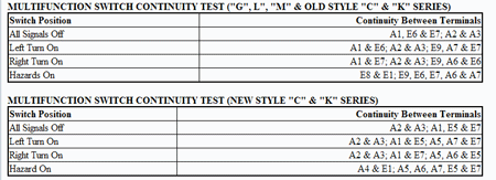

I have no brake lights
1- turn signals work.
2- tail lights work.
3 -light over the back doors comes on when you step on brakes.
4-4 way flashers don't work
any ideas will help
thank you
Feb 27, 2008 at 2:34 AM
MERLIN2021
  • 17,250 POSTS
You need to test the multifunction switch...
https://images.2carpros.com/forum/automotive_pictures/62217_Multifuntion_copy_1.gif
