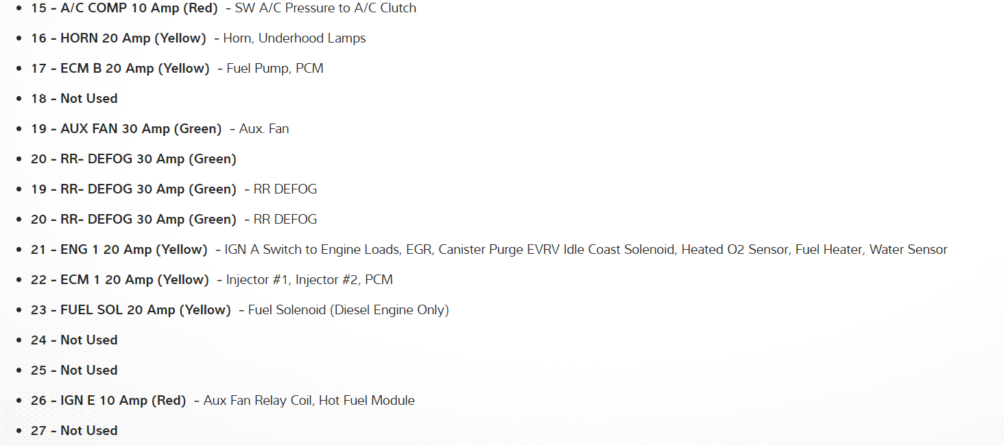

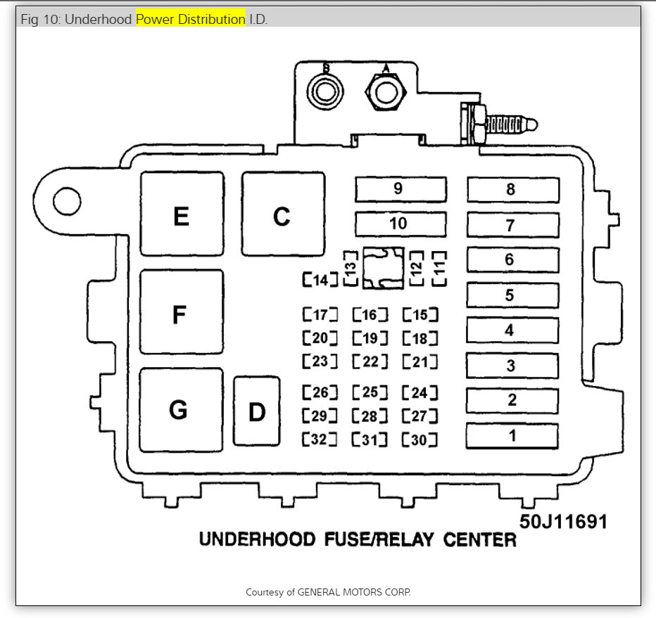

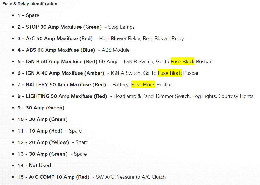

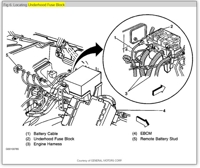

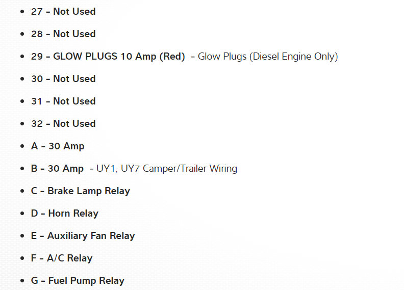

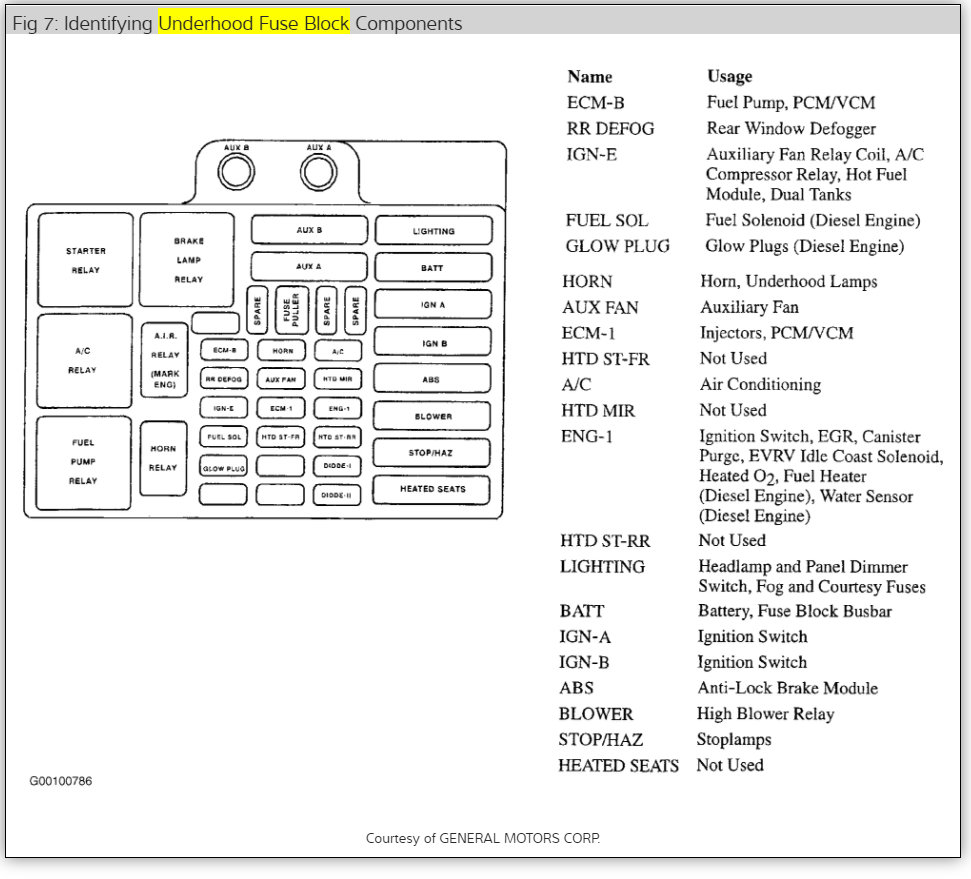

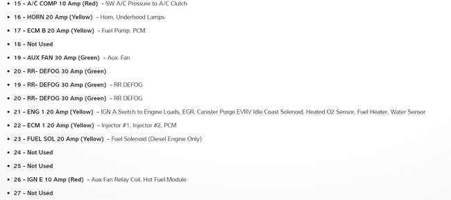

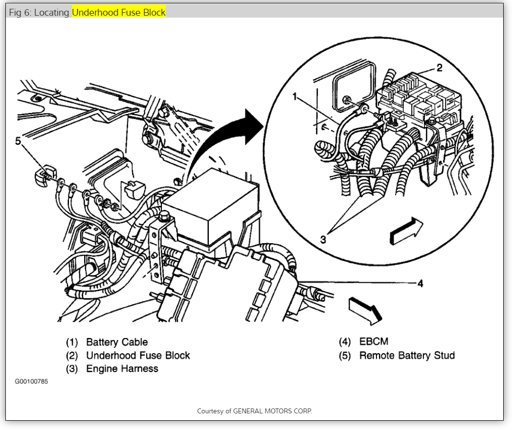

Where is the fuel pump relay located on a 99 tahoe?
Tuesday, March 2nd, 2010 AT 3:39 PM
DOCFIXIT
MECHANIC
18,828 POSTS
Here is a guide to help you test the relay and the relay location is the diagrams below:
