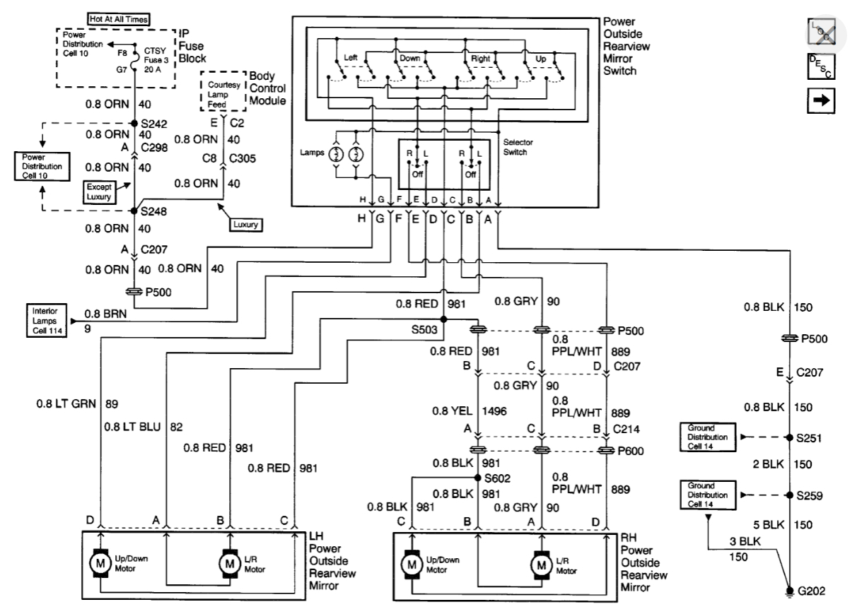

for some odd reason my mirrors wont work all the fuses say they are good what can be my problem

Unless you have already done it, I will suggest you use a test light to check the fuse.
The fuse is located in the fuse block under the hood.
It could also be a wiring issue. I have attached the wiring diagram for your mirrors.
