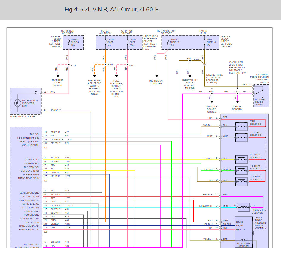

I have a 2 wheel drive 99 Chevy Tahoe with a strange problem. When I start the Tahoe in the morning it drives fine. After about 5 minutes of driving the transmission stops shifting. It appears that after the transmission warms up it loses pressure internally and just stops shifting, leaving the truck in neutral. Plus, all the time that this has been happening there are no trouble codes, nor does the check engine light come on.
Every transmission place and the local Chevy dealer all claim that they will do a diagnostic but the only response I get is that I need to have the transmission rebuilt. Is there any way to determine exactly what the problem is and have that fixed or do I truly need to have the transmission rebuilt?

A pressure test on trans will tell if it is internal. If pressures are good could be shift solenoid fault.

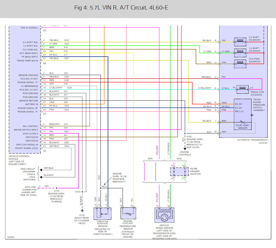

This sounds more like you have a problem with a shift solenoid. Here is a guide that shows how to drop the pan and the wiring diagrams so you can see which solenoid to change out.
you will need to raise the car up safely.
Here are the transmission wiring diagrams (below) It is the solenoid with the white wire.
