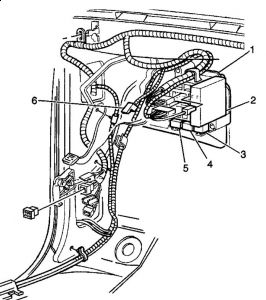

My blinkers on my 98 tahoe just went out when i was pulling a trailer in the rain. I checked all the fuses and the break/hazard lights still work. What should I try next?

Try the flasher on the convenience center.
https://images.2carpros.com/forum/automotive_pictures/62217_Flashera_1.jpg
https://images.2carpros.com/forum/automotive_pictures/62217_flasher_b_1.jpg
