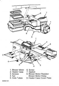

How do you replace the A/C ,Heater fan motor?

Disconnect neg battery cable.Remove glove box and lower kick panel.Unplug ECM is necessary, unplug blower motor, remove cover and cooling tube.It should have about 4-5 7mm or 8mm screws holding it in
https://images.2carpros.com/forum/automotive_pictures/1639_Graphic_4.jpg
Check out the guide below, it will help https://www.2carpros.com/articles/blower-fan-motor-works-on-high-speed-only

I can not remove the blower motor cover so I can replace the motor. I can pull it back but not far enough to get to the screws on top holding the motor. The cover go up past the motor about 6 more inches and goes back about four more inches. Do I need to take the dash out?
https://images.2carpros.com/forum/automotive_pictures/152336_DSCF3856_1.jpg
https://images.2carpros.com/forum/automotive_pictures/152336_DSCF3860_1.jpg

Did you ever get an answer on how to remove the blower motor cover (and replace the blower motor). I'm trying to do the same thing...
