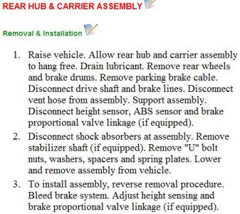

can you list the steps to removing and replacing the rear wheel bearings.
