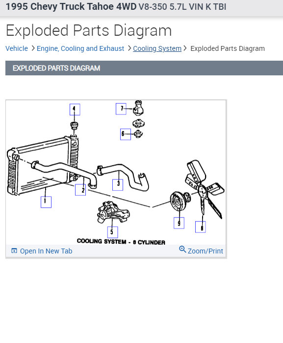

I have a leak from the front of my 95 tahoe. It is increasingly getting worse. I fill it up with water on a daily basis. Originally thought it to be water pump, but someone looked at it and said they did not think it is the water pump, could be something else. What else could it be and how can I tell. It is leaking from the front, not the radiator but a little beind. When I fill the tahoe with water it starts leaking out the bottom.

This leak can be from one of the radiator hoses. Over time those hoses will get weak and can start to leak.
Is the leak on the engine block or close to the radiator?
https://www.2carpros.com/articles/car-is-leaking-coolant
Do a thorough inspection to see if you can actually see the leak and where it is coming from.
It could be helpful to do a pressure test of the cooling system. When the cooling system gets pressurized during the test, it makes it easier to locate leaks.
