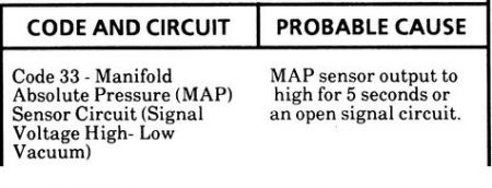

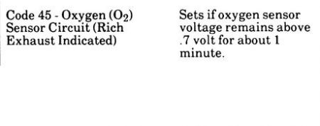

FALKON
When I place the jumper between a-b terminals the service engine light blinks in this pattern 1 flash a pause and them 2 flashes it repeats this sequence 3 times next sequence that repeats 3 times is 3 flashes and pause with anither 3 flashes and the next 3 time repeating sequence is 4 flashes with a pause and another 5 flashes.
My question is what does these flashes represent or wher can I find out what these flashing codes mean

JDL
  • 16,098 POSTS
http://www.2carpros.com/forum/automotive_pictures/170934_chevy_tahoe_1.jpg
http://www.2carpros.com/forum/automotive_pictures/170934_chevy_tahoe_11_1.jpg
Usually code 12 means, diagnostic mode.
