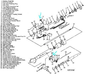

i have a 92 chevy suburban 4x4 with 145000 miles. it has the 5.7 liter engine. Recently it started acting up like the ignition, or fuel was cutting out. When it finally died,I tried to restart it, and the starter would not disengauge. The only way to stop it was disconnect the battery.When I reconnect the battery, it does not do anything until I attempt to start it. I replaced the starter, it still would not disengauge. I replaced the ignition switch, no change.
The battery load tests good. I am totally lost. It sounds to me like a relay is sticking, or something is back feeding the starter, but the schematics I have do not show a relay in the system. Please help

Did you replace the lock cylinder at the top of the column or the ignition switch as the bottom of the column. I would be suspicious of an internal problem in the column.
https://images.2carpros.com/forum/automotive_pictures/30961_stcol_1.jpg
Jan 23, 2007 at 12:17 PM
KELLY WISDOM
  • 5 POSTS
I replaced the ignition switch on the bottom. The key cylinder is moving freely. When I turn the key to the off position, all of the lights on the dash, radio,etc go off.

Hopefully someone else can jump in on this to take you further.
Food for thought is the best I can offer. When a bad starter is sent back as a core, the "bad" part is replaced when it is "rebuilt", If it is "remanufactured", all wear parts are replaced. It is typical of poorly skilled rebuilders to miss a problem and the unsuspecting next customer gets a problem that is the same as they had. I'm not saying your replacement starter is the problem, but don't overlook that as a possiblity. Perhaps the starter solenoid can be isolated to test.
