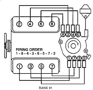

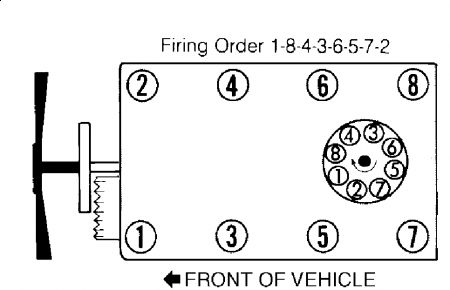

Slack in timing chain replaced it. When the marks are at 6 (o'clock cam) and 12 (o'clock crank) the distributor is pointing at coil ( general direction on cap) what is the firing order?
Sunday, August 2nd, 2009 AT 3:11 PM
MERLIN2021
  • 17,250 POSTS
Old Style
https://www.2carpros.com/forum/automotive_pictures/62217_old_Style_1.jpg
New Style
https://www.2carpros.com/forum/automotive_pictures/62217_new_Style_1.jpg
+1
Monday, August 3rd, 2009 AT 2:33 AM

Ok I have the firing order now, what is the distributor sequence at TDC. Which cylinder should be firing at TDC. As previously posted at TDC the rotor is pointing to the #6 wire.
Monday, August 3rd, 2009 AT 4:32 AM
MERLIN2021
  • 17,250 POSTS
Position #1 Cylinder a TDC, then set plug wires starting with #1 wire to #1 plug, and follow the rest of the firing order sequentially. Point the rotor to fire the #1 plug! If you have the old style, it shows you are off by 180 degrees!

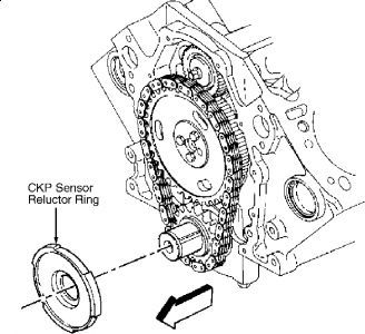

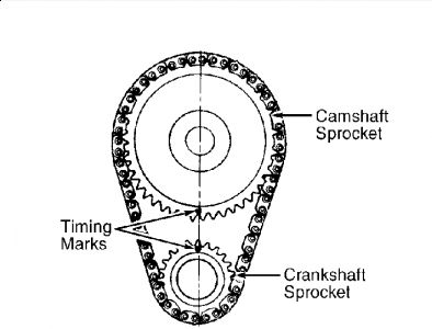

https://www.2carpros.com/forum/automotive_pictures/62217_1_14.jpg
https://www.2carpros.com/forum/automotive_pictures/62217_2_14.jpg
Installation 1. Install Woodruff key in crankshaft (if removed). Using Crankshaft Sprocket Installer (J-5590), install crankshaft sprocket. Install camshaft sprocket and timing chain. Ensure timing marks on sprockets are aligned. See Fig. 5 . 2. Balance shaft drive gear, driven gear and gear bolt are serviced as a set. Install and tighten camshaft sprocket bolts to specification. See TORQUE SPECIFICATIONS table. 3. Install and align CKP sensor reluctor ring. See Fig. 4 . Install NEW front cover and gasket. Tighten front cover bolts to specification. See TORQUE SPECIFICATIONS table. 4. Install CKP sensor. Tighten CKP sensor holddown bolt to specification. See TORQUE SPECIFICATIONS table. 5. Apply RTV sealant to Woodruff keyway in crankshaft balancer. Using Damper Puller/Installer (J-23523-F), install crankshaft balancer. Tighten fasteners to specification. See TORQUE SPECIFICATIONS table. To install remaining components, reverse removal procedure. Fig. 4: Removing/Installing CKP Sensor Reluctor Ring Courtesy of GENERAL MOTORS CORP. Fig. 5: Aligning Timing Marks Courtesy of GENERAL MOTORS CORP. CAUTION: Failure to properly align CKP sensor reluctor ring may result in component damage and could affect system performance. CKP sensor reluctor ring is shaped like a dish. Dished side of CKP sensor reluctor ring must face engine front cover. NOTE: DO NOT reinstall original composite front cover. Always install a NEW front cover. Reinstalling original front cover can lead to oil leaks. CAUTION: Ensure CKP sensor is fully seated and held stationary in bore of front cover upon installation. A CKP sensor that is not fully seated may result in erratic engine operation. Page 1 of 1 8/5/2009
