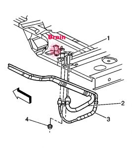

2001 Chevy Suburban 101,000 miles+, 3.5. The air condition is draining in my back floor board. I can not find the drain plug for the rear air conditioner condenser. I need either a diagram or directions to it. :oops: Thanks Sherrie

From under the truck get a piece of plastic or hard rubber item that will fit in the drain or use compressed air like a can of computer duster air and clean out the hole, keep face clear!
https://images.2carpros.com/forum/automotive_pictures/62217_Drain_copy_1.jpg
https://images.2carpros.com/forum/automotive_pictures/62217_30961_mitchell_2_18.jpg
