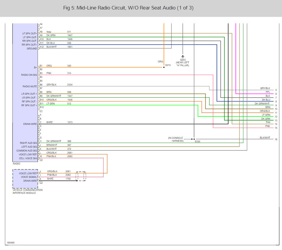

radio turns on all the dials work including the volume, but I cannot hear anything. It was working when I was in the car and I came home for a few minutes got back in and guess what no sound can i get radio wiring diagrams. Any ideas?

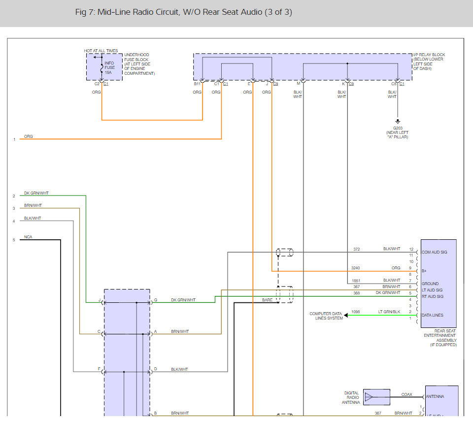

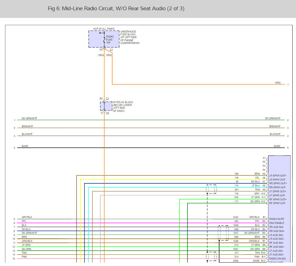

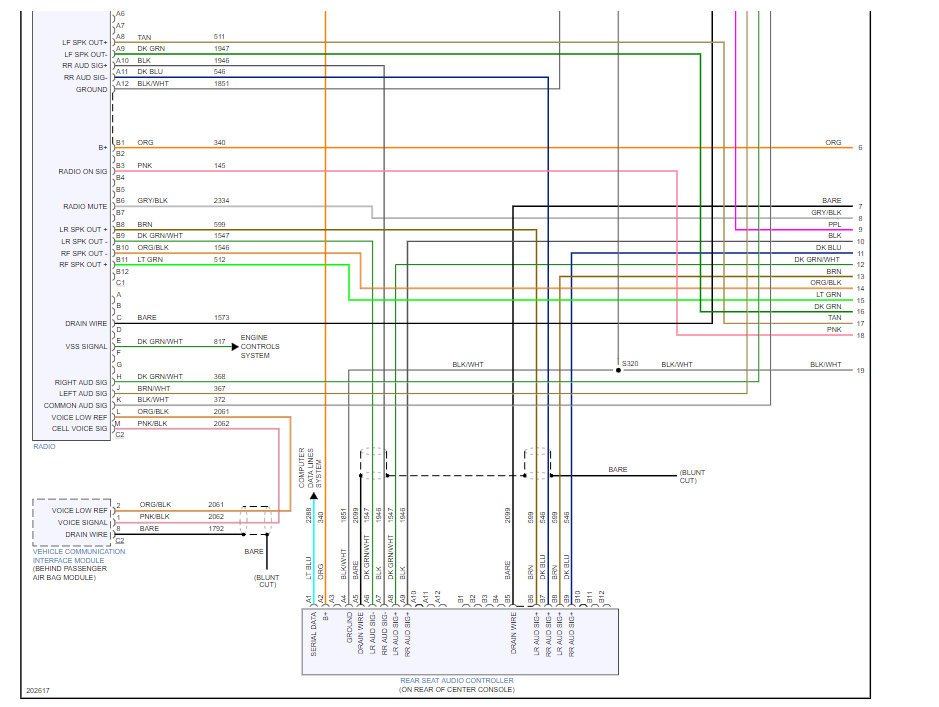

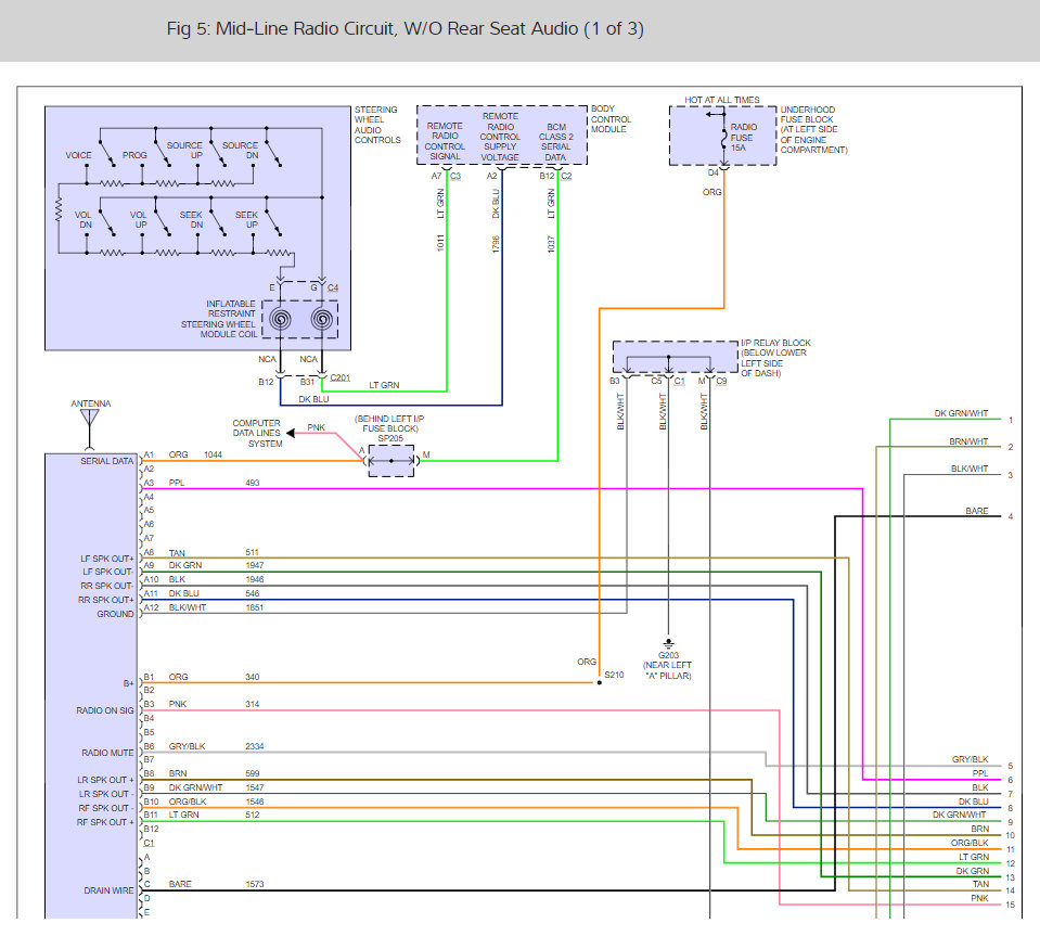

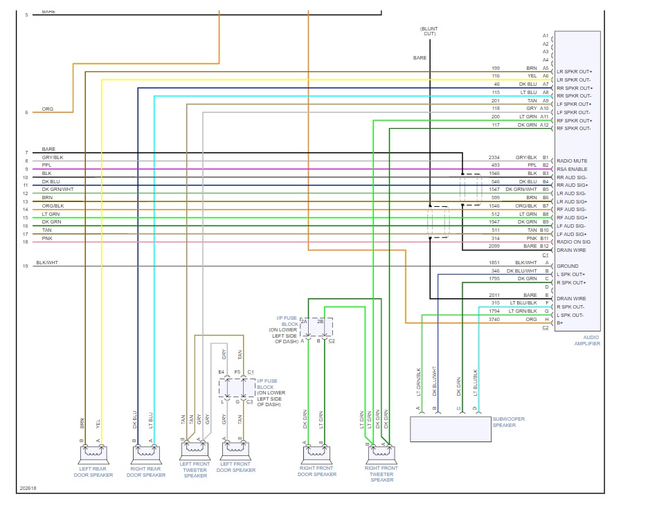

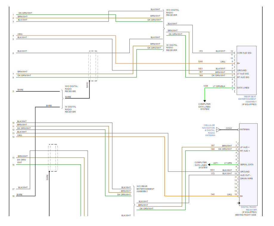

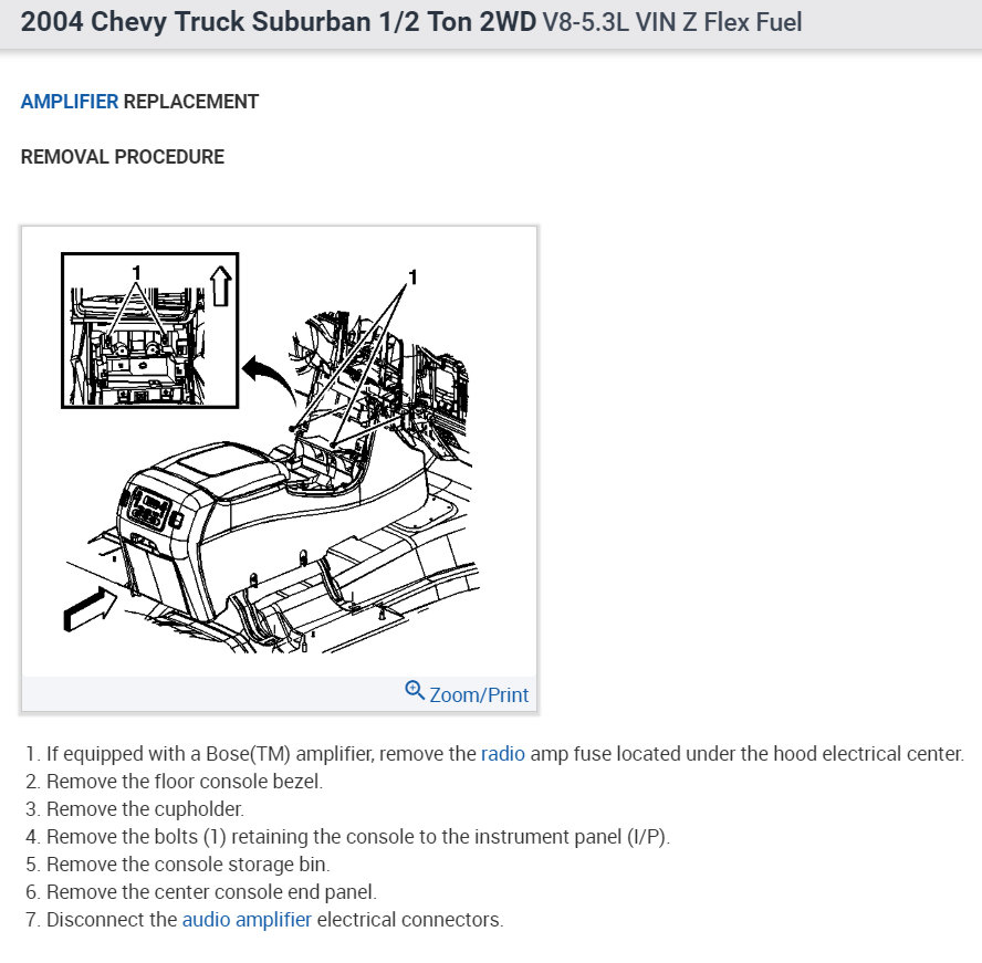

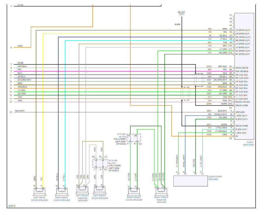

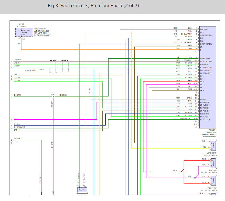

It sounds like you have an amplifier or head unit (radio) that has gone out. Here is a guide for you to check the power and ground of the amp. If it checks out then the radio is bad.
Here is a guide and some wiring diagram (below) so you can do some testing:
and
(The wiring diagrams are below)
Here is a bulletin from the factory I found:

I checked out the wiring diagrams and found the amp is getting power and has a good ground so I think it is good.
I used the balance and fader controls to single out each speaker. could be a short in one of the speaker wires.
Usually when this happens you will just get a static distorted sound but with these newer factory stereos there could be an internal breaker that shuts off the speaker output when a short is detected. may not be the case but it could not hurt to check it out.

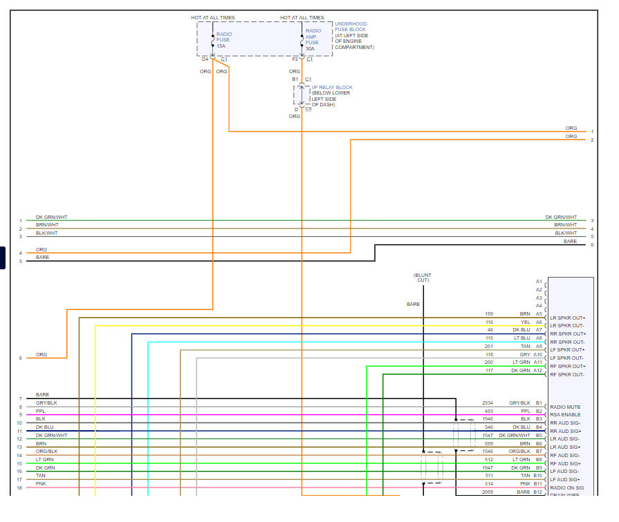

Check the fuse in the under hood fuse panel. If that is okay these radios have a problem with the internal amplifier going out which will cause the problem you are describing. You must replace the radio to fix it.

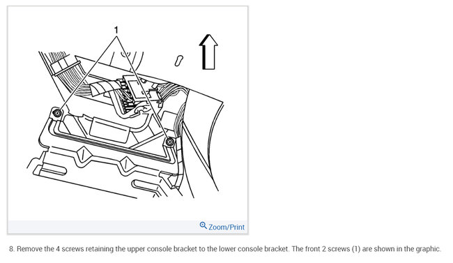

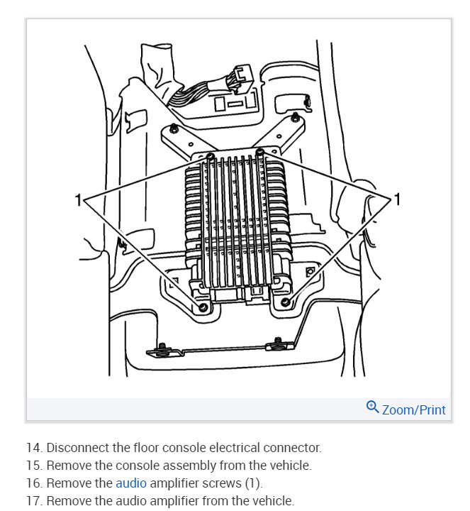

Yes, the amplifier went out causing the issue. Make sure the unit is getting power and ground to confirm the failure by using the wiring diagrams from above. Here is the location.

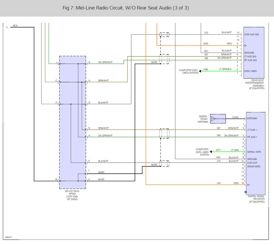

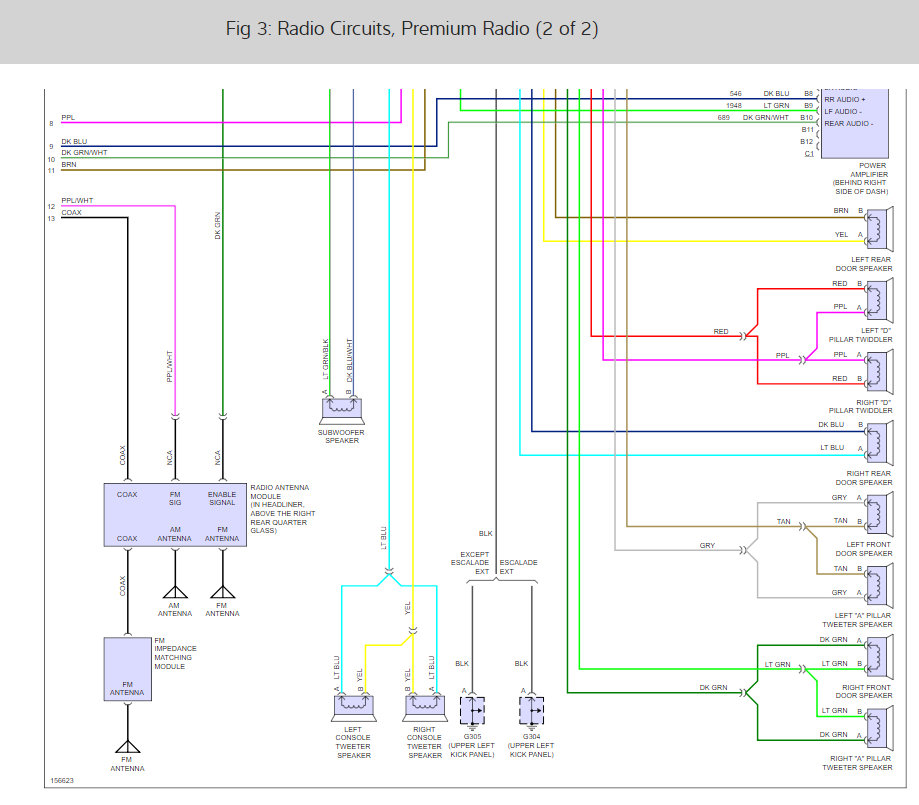

It sounds like the vehicle communication interface module could be going out. Here are the wiring diagrams so you can see how the system works. Check out the diagrams (below). Please let us know what you find. We are interested to see what it is.

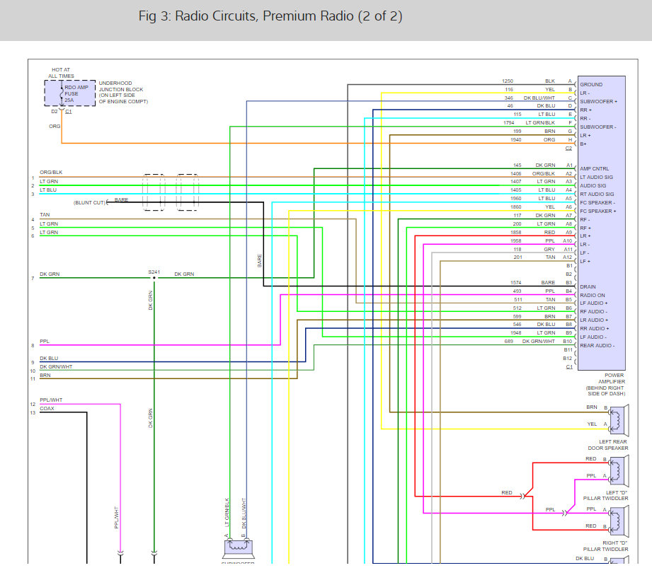

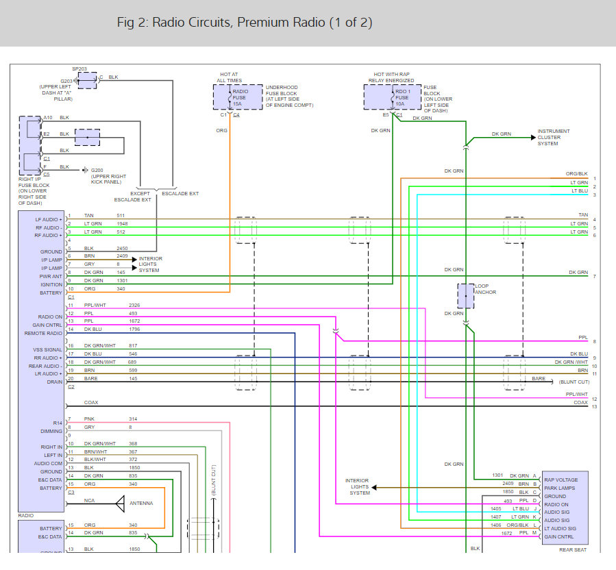

My dad and I are trying to hook up an aftermarket radio into my vehicle. We made all the shown connections and we get power to the stereo, but no sound. We even tried using the blue wire for the amp.
May 26, 2021 at 4:22 AM (Merged)
  • 55,433 POSTS

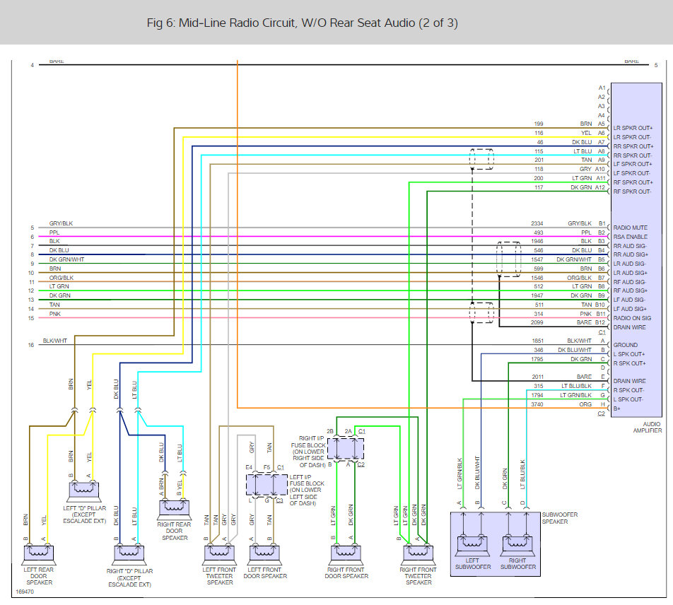

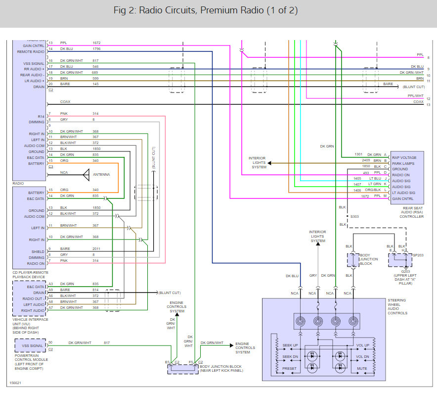

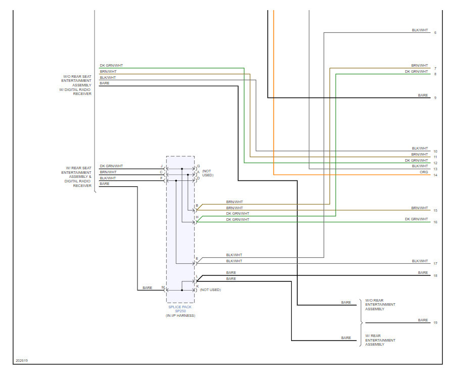

It sounds like the amp is still not turning on. Did you use an adapter to wire the radio or are you doing it without? There are two power wires (dark green and purple) to the amp. Here are the wiring diagrams so you can see how the system works:

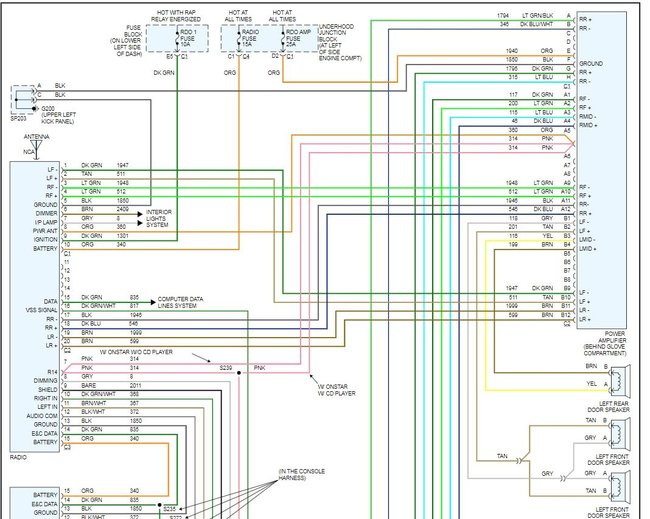

Do you have the wiring schematic for the radio amplifier I changed the radio to after market and connected the new harness adapter but it still doesn't work and I need to bypass the original amplifier.

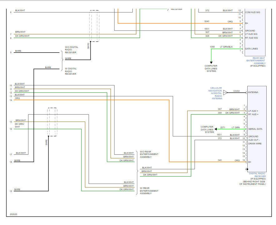

CARADIODOC
  • 34,381 POSTS
Here you go.... thanks for using 2Carpros.com
Let us know if you need anything else

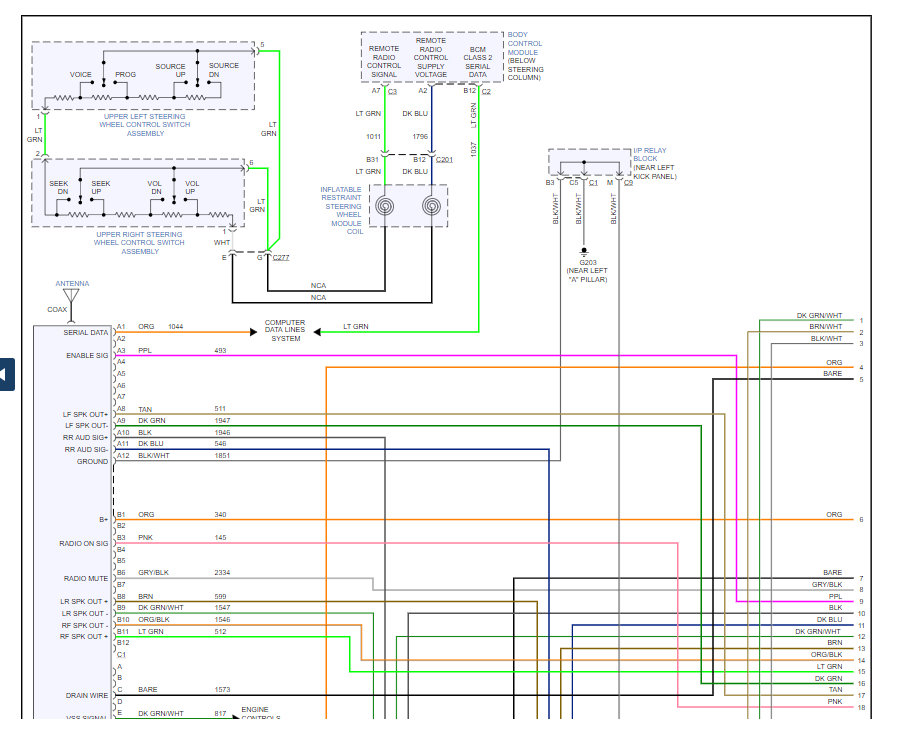

SUBURBAN454

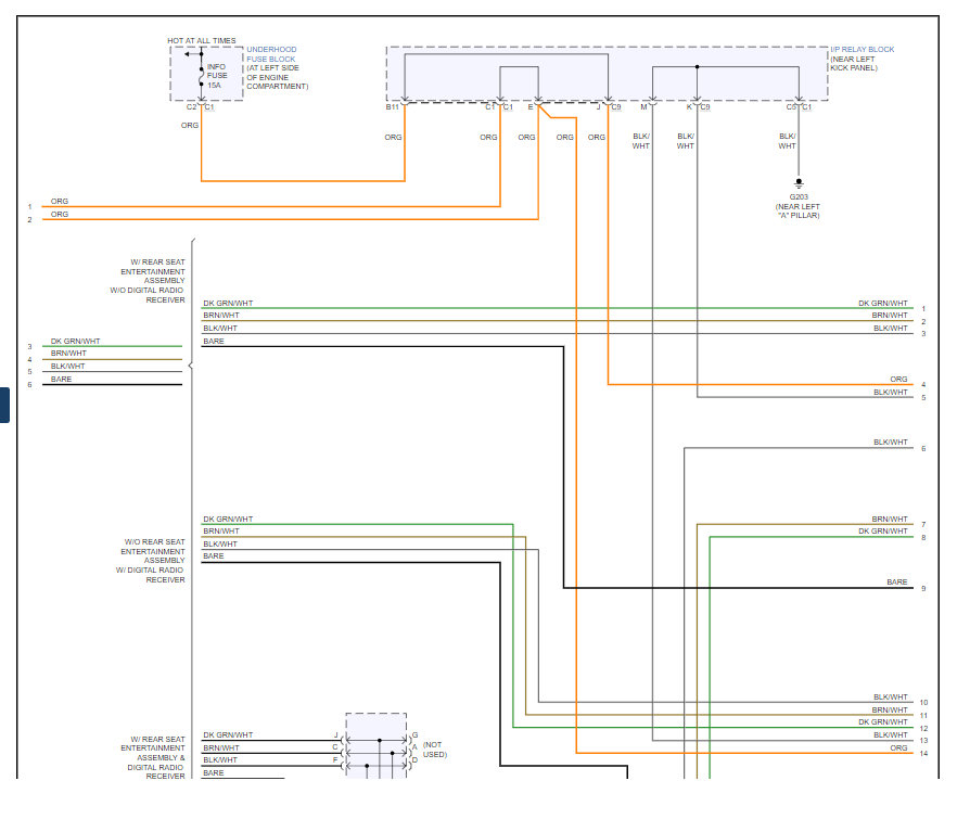

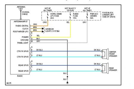

ok my suburban the radio wont work and the dash lights wont work but the headlights will and turning signals ect. and i cant find the fuse or the problem can someone help me please
HMAC300
  • 48,601 POSTS

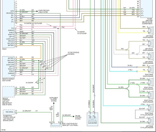

here are two diagrams. I'd bet that if you fix one of the fuses that they show for the radio your dash lights will work again. If not they are either burnt out(bulbs) or you may have a bad headlight switch....
https://images.2carpros.com/forum/automotive_pictures/406719_radio_1.jpg
https://images.2carpros.com/forum/automotive_pictures/406719_radio_2.jpg
You can click on these and they should download to make bigger

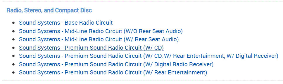

  • 110,244 POSTS

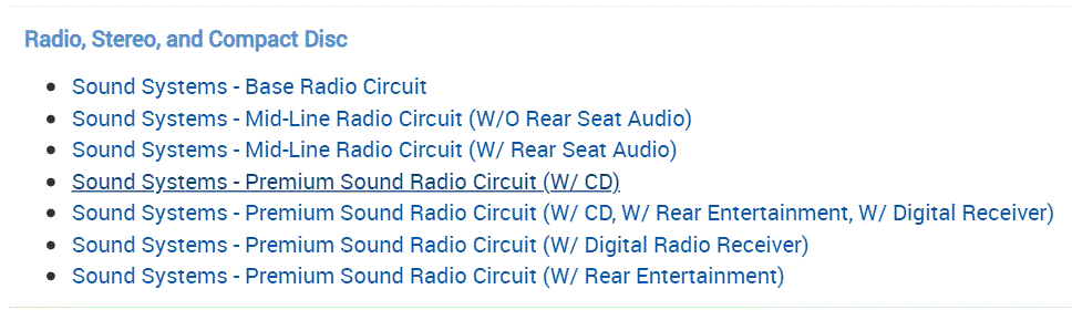

Can you tell me which system you have? For example, do you have a basic radio or front and rear audio with navigation?
This may require a factory reset based on the system you have. Also, the radio or amplifier may have an internal circuit issue. I'm not sure where you are located, so let me know if there is anything you can think of that makes it better or worse. For example, when it's extremely cold it's worse.
I attached a pic below showing the options.
