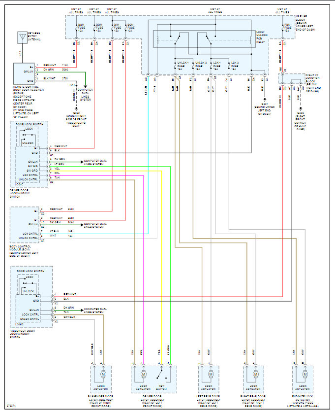

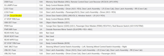

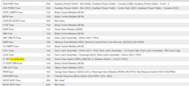

I am attaching the wiring diagram. I suspect we just have failing actuators as this was pretty common on these trucks. I would suggest testing power at the actuator and if there is, replace it. Let us know if you need help with this. here is a guide that should help:

Everything points to the body control module or the main switch in the drivers door which all circuits run through. I can't believe you would have 3 bad switches or 3 bad actuators or a combination there of. My cut and paste is down, but if you have access to a fax I can send you a wiring diagram.

Mike, there are 3 different lock systems used in your suburban. One is ruled out because you have remote entry. Narrowing down the remaining two. Do you have a lock switch on the driver's door control that will disable the rear door lock systems? Also, on your keyless remote, if you push the button "once" does it unlock the driver's door only and have to push it again to unlock "all" the doors? It may not work that way now but, is that the way it is supposed to work?
The body control module is under the left side of the dash by the steering column.
Again, if you have access to a fax, I'll send you diagrams so you will know what I'm talking about. It may just be a relay and not the BC module.
One more thing, if you try to lock or unlock the right rear door from the driver's door, do you hear anything from the RR door?

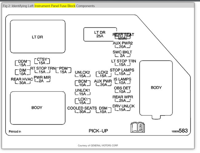

there are 4 fuses with this circuit and 1 jumper. go to autozone for electrical scematic. all contained of the left fuse panel. not sure where jumper is. check all.

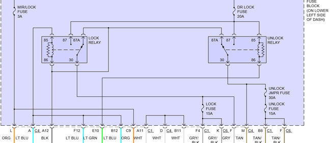

My door locks will not operate. The relay clicks and the lights flash on the outside and the horn activates, but the doors will not lock. It started when it was a rainy day, and it corrected itself when I turned the front and rear heater on high and let it cook for an 1/2 hour. But after a wet day the problem returned. Now the heat wot help it! I replaced all the relays and pulled apart all the plugs and lubed them w/ switch grease. I checked all the fuses. How much does the Body Control Module play a role in this circuit? I am at wits end... almost! Please reply.

BCM does it all but if your sure the relay clicks then BCM is doing it's job. Can you lock doors from master panel? Will key unlock the doors?

The key will unlock the door, but when you try any door including the drivers control, all you hear is the relay click. When you push the lock on the key remote, the horn beeps and the lights flash, but no lock.

O. K. as I understand not able to lock doors via key or master control but relay clicks, horn etc.
Need OHM meter pull lock relay find terminal # 30 probe then, may need to unbolt fuse block, find two Gray/ black wires probably next to each other. Place other probe on one of them What does it read?
If open then wire faulty .
