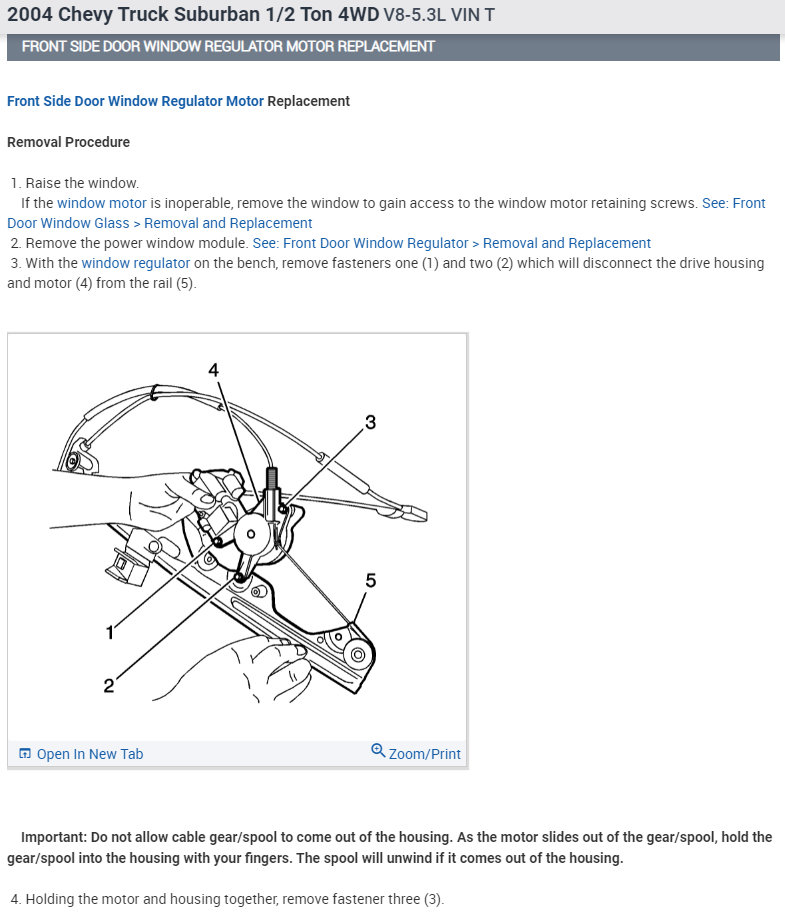

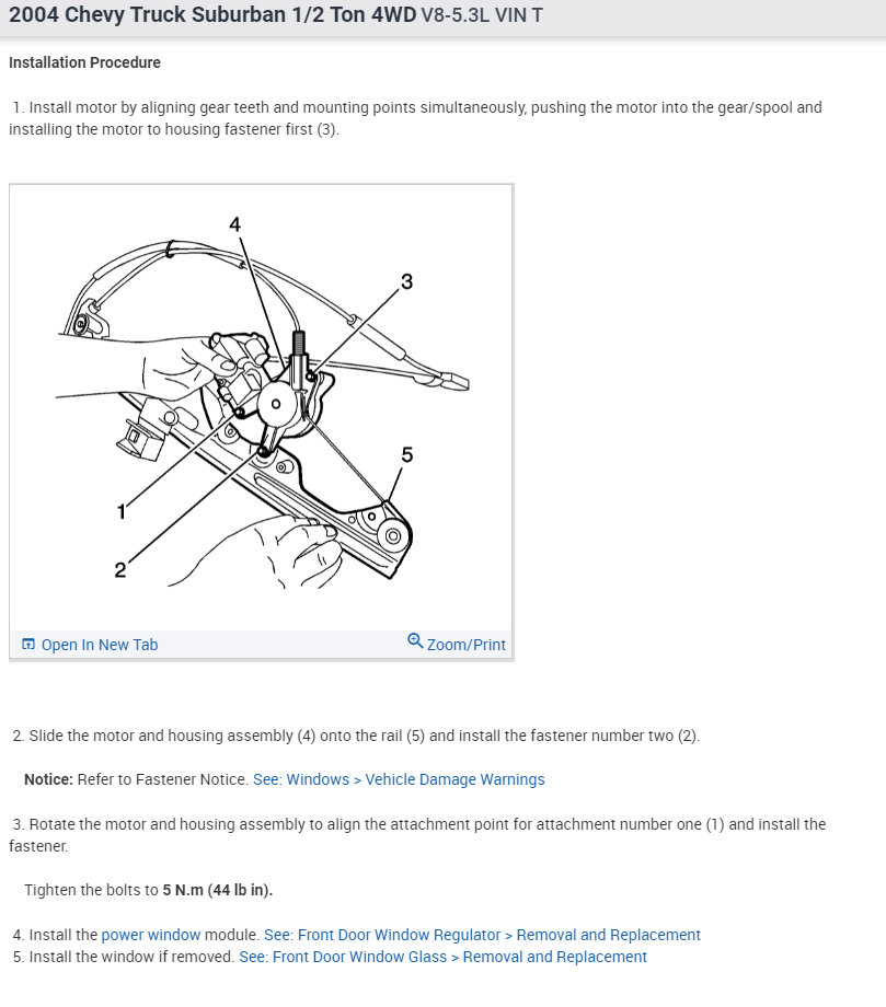

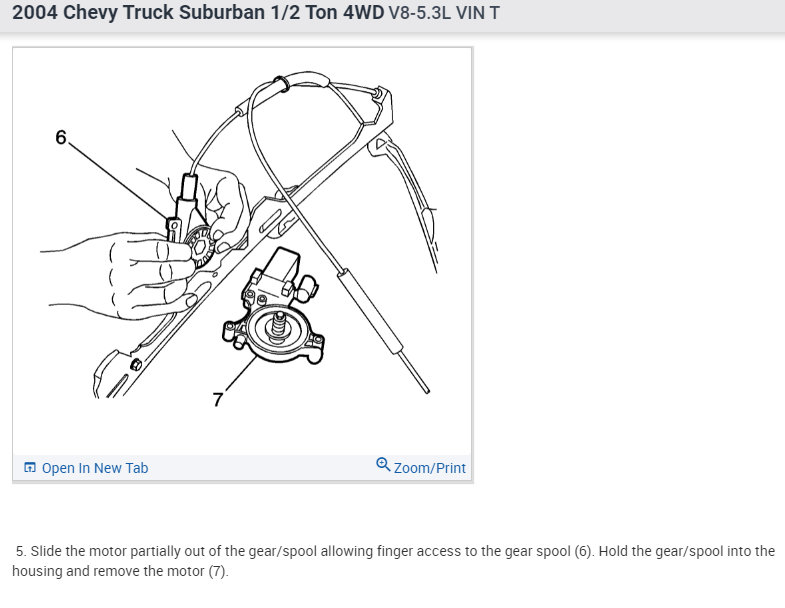

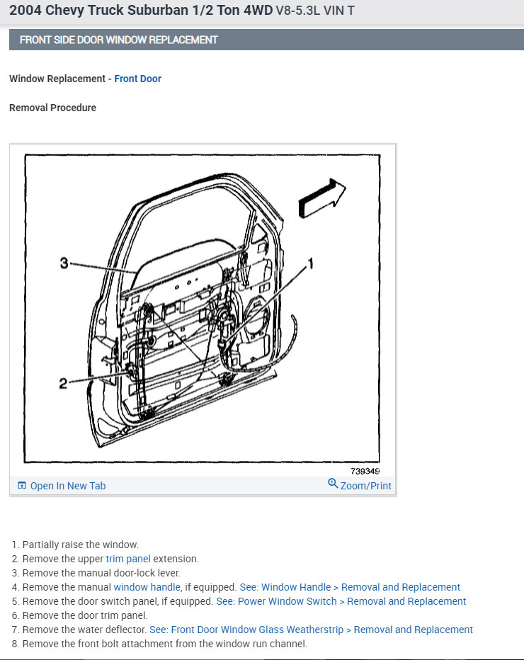

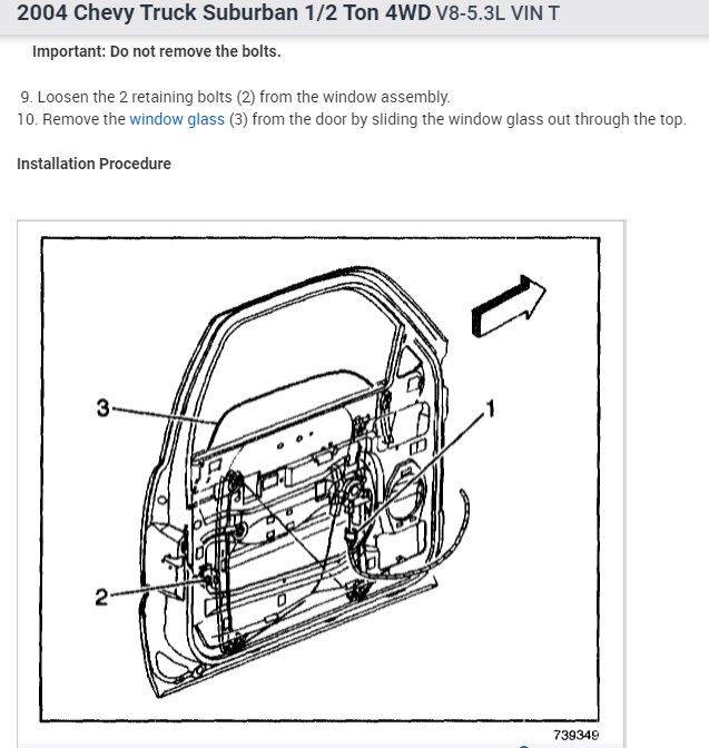

This could be due to a faulty window regulator. If you hear the click on the switch, it means the switch is producing power, but the motor is not operating.
Take a look at this video, it shows how to test the window switch and motor:
https://youtu.be/HBFBcJrdym4
In order to access the window motor, you will have to remove the inner door trim.
Which is mounted by few screws and several plastic fasteners.
Here is a helpful guide:
https://www.2carpros.com/articles/how-to-check-and-replace-a-electric-power-window-motor
