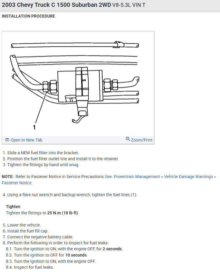

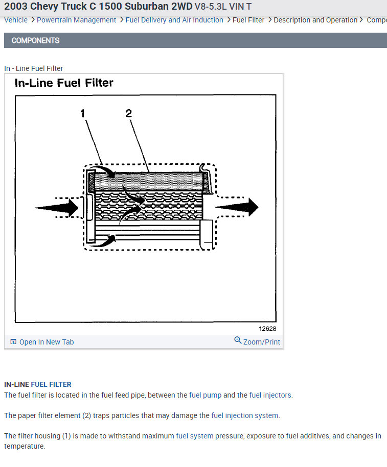

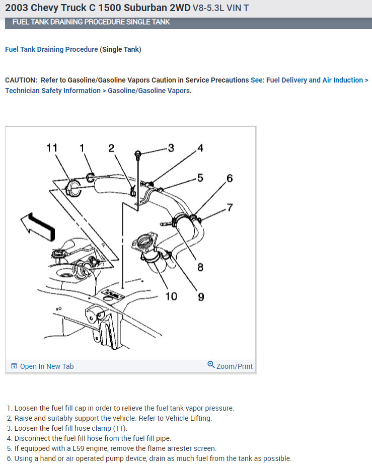

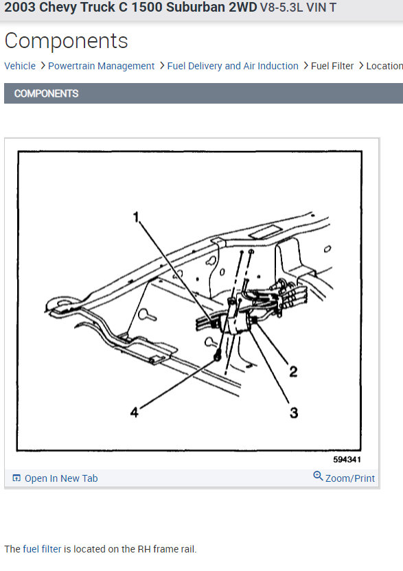

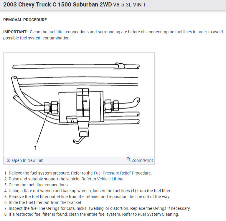

The oxygen sensor might not be connected with the drivability issue that you are experiencing. As it does sound like you got bad gas. If there is excessive amount of water in the tank the best course of action is to drain the tank and put in good fuel. Also change out the fuel filter.
Run some fuel stabilizer/injector cleaners thru it and fill it up. That typically takes care of the issue.
https://www.2carpros.com/articles/how-to-change-a-fuel-filter
As for the oxygen sensor, are you still getting the code for the oxygen sensor?
Here is a helpful guide of how to test oxygen sensor:
https://www.2carpros.com/articles/how-to-test-an-oxygen-sensor-02-sensor
I have attached the fuel filter replacement as well a fuel tank drain instructions.
