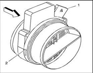

First, remove the MAF sensor from the vehicle. The MAF sensor should always be located in the air duct between the air filter and the throttle body. Picture of MAF sensor connector location (1) and flow direction (2) for 2000-2005 4.8L, 5.3L, 6.0L engines below.
https://images.2carpros.com/forum/automotive_pictures/261618_0900c152800a6a9e_1.jpg
NOTE: DO NOT USE CARBURATOR CLEANER! To clean, spray some electrical contact cleaner (something that leaves NO residue) through the sampling tube over the wires. I recommend using a MASS AIR FLOW cleaner from your local auto parts store. It is specially made for this job and only costs a few dollars. Start with this first, post your results and if it doesn't help your issue then we will go on to the fuel filter. I think this will do it for you though. Thanks for using 2carpros.com!
