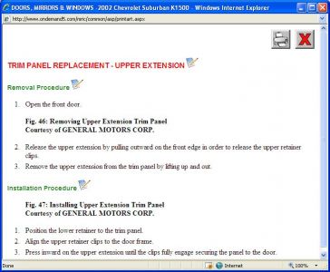

My window on drivers side was going up very slow and finally quit working altogether and now just clicks when I push the button. Is this most likely a motor problem or regulator and is it difficult to replace both or either?

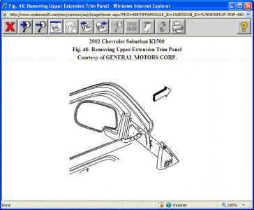

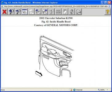

Most likely you have a weak motor but you will have to get in there and make sure you have power and ground going to the motor.Also that nothing is worn out or broken on the regulator.It's only 69 plus shipping for the regulator with motor so i would just replace the whole thing.You will need to remove the inner door panel and see if you have power and ground to the motor if you do let me know and i will help you find the part's.Do you have the k model or C model Suburban?Also is it a 1500 2500 etc?Let me know so i can get yo the info for taking the door panel off.

https://images.2carpros.com/forum/automotive_pictures/416332_2002_chevy_k1500_suburban_inside_door_panel_part1_1.jpg
https://images.2carpros.com/forum/automotive_pictures/416332_2002_chevy_k1500_suburban_inside_door_panel_part2_1.jpg
https://images.2carpros.com/forum/automotive_pictures/416332_2002_chevy_k1500_suburban_inside_door_panel_part3_1.jpg
https://images.2carpros.com/forum/automotive_pictures/416332_2002_chevy_k1500_suburban_inside_door_panel_part4_1.jpg
https://images.2carpros.com/forum/automotive_pictures/416332_2002_chevy_k1500_suburban_inside_door_panel_part5_1.jpg
https://images.2carpros.com/forum/automotive_pictures/416332_2002_chevy_k1500_suburban_inside_door_panel_part6_1.jpg
https://images.2carpros.com/forum/automotive_pictures/416332_2002_chevy_k1500_suburban_inside_door_panel_part7_1.jpg
https://images.2carpros.com/forum/automotive_pictures/416332_2002_chevy_k1500_suburban_inside_door_panel_part8_1.jpg
https://images.2carpros.com/forum/automotive_pictures/416332_2002_chevy_k1500_suburban_inside_door_panel_part9_1.jpg
There you go i also emailed you the info let me know what you find.
