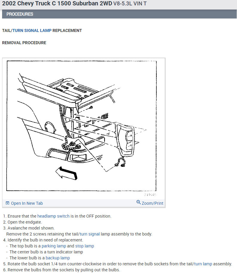

how do you replace rear brake lights?
2002 CHEVROLET SUBURBAN
100,000 MILES • V8 • 2WD • AUTOMATIC
LARRY SPENCER
Jul 28, 2009 at 9:56 AM
SQM
  • 6,383 POSTS

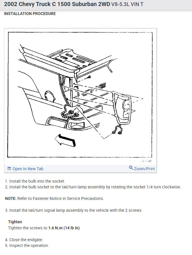

The brake lights can be replaced easily on this vehicle by removing the taillight assembly.
To remove the taillight you will have to remove the 2 screws that keeps the light assembly in place.
After removing the screws just pull outward and the taillight will come out.
Then you will be able to twist and remove the bulbs from the housing and replace as needed.
