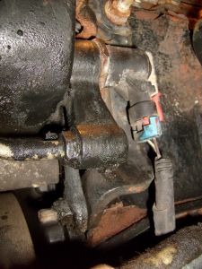

JOHN VINTI
  • 11 POSTS
Steering problem 1999 Chevy Suburban V8 Two Wheel Drive Automatic 155000 miles You were exactly correct the shaft on the power steering unit is sheared. I can not find a power steering pump with the EVO electrical plug receiver on. Does the EVO inlet from the old pump thread off? Can I thread it onto the new unit? A GM dealer told me my GM pump part no. 26069033 has been discontinued. Maybe I'm asking the wrong questions but all I can find is the pump without the EVO (what I call the electronic plug attachment) on the unit. What are my options. Thanks for the great diagnosis!!! john Picture shows bottom of pump with electrical line and fluid line
https://images.2carpros.com/forum/automotive_pictures/2562_S6300380_2.jpg
May 23, 2017 at 4:33 AM (Merged)
DOCFIXIT
  • 18,828 POSTS
Try NAPA for a rebuilt pump also see if GM can get pump 26069034 it is superseeded part.
