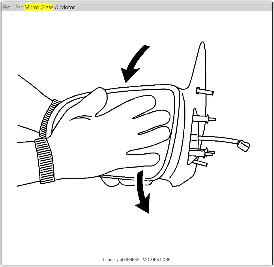

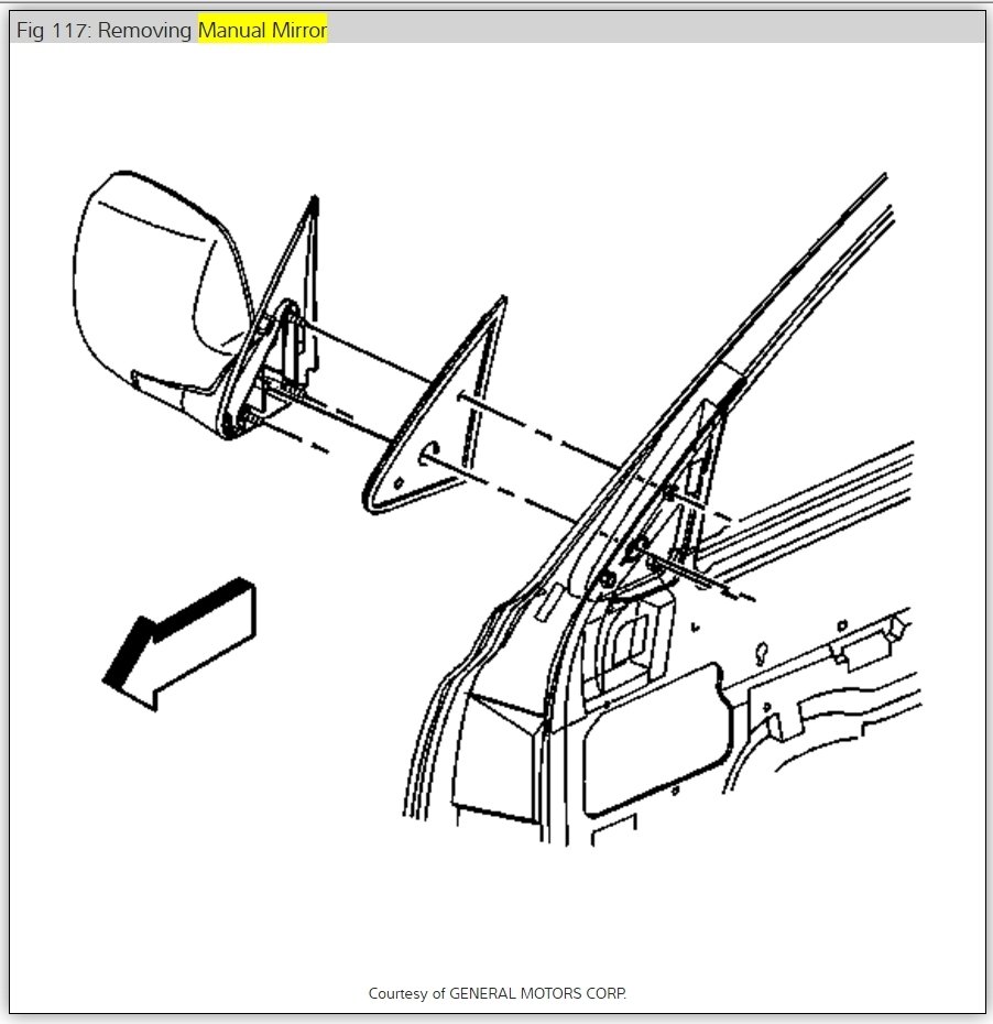

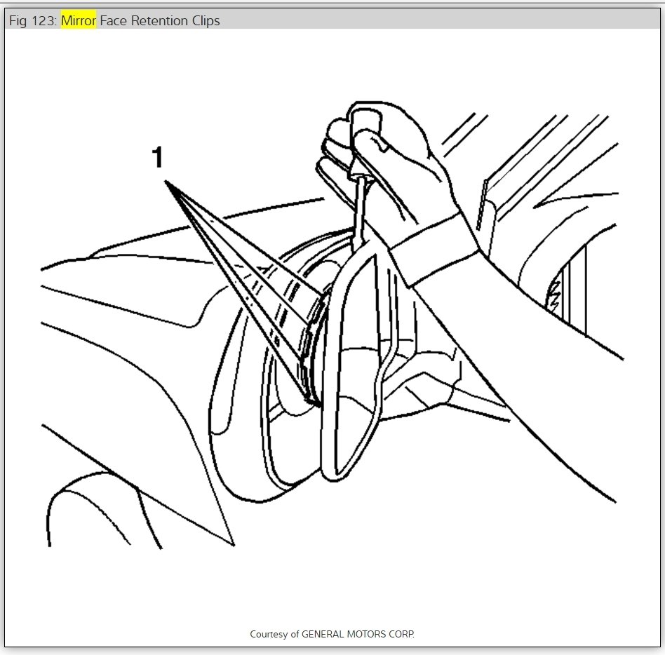

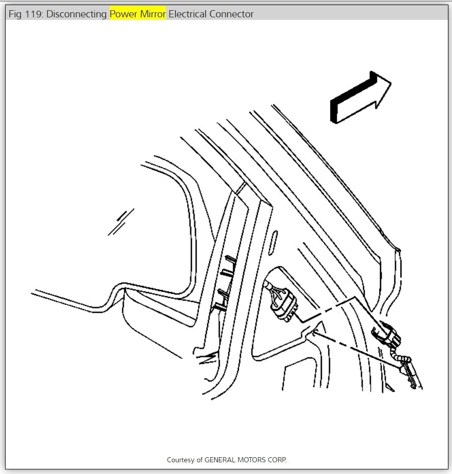

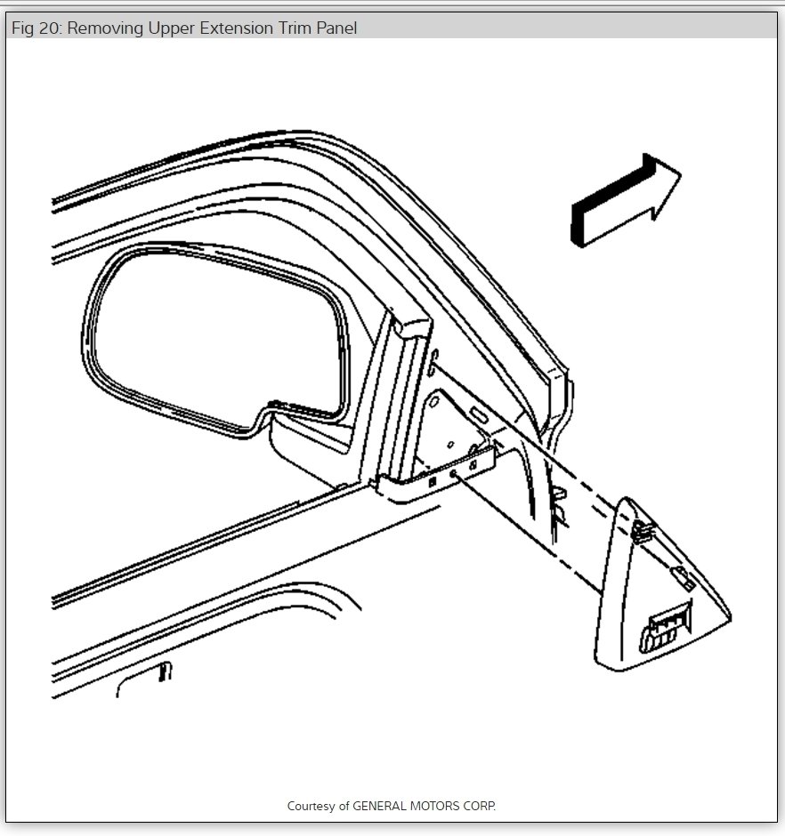

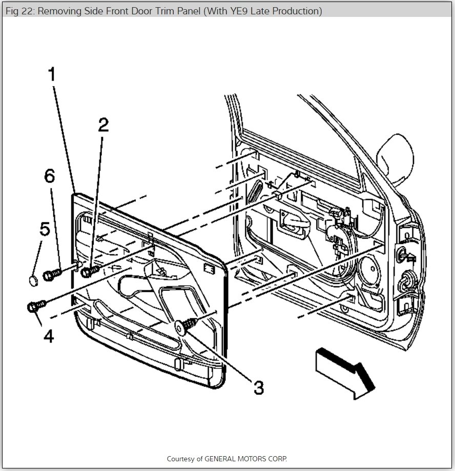

How do I replace a side mirror on my car?
Dec 14, 2009 at 11:01 AM
Experienced Mechanic
55,588 POSTS
Hello CAPTYTOM,
You must start by removing the door panel which we have a guide for below, Then undo the wiring connector and while holding the mirror with one hand undo the mounting bolts.
https://www.2carpros.com/articles/door-panel-removal
Here are some diagrams to help with the job.
Please let us know happens so it will help others.
Best, Ken
