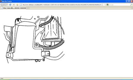

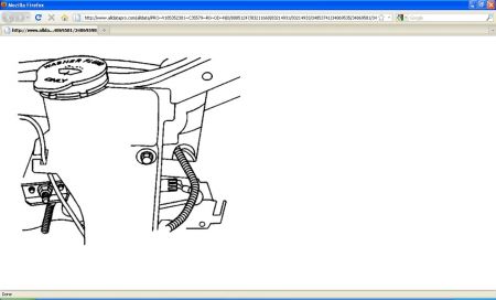

The container that holds my windshield washer fluid has a crack in it and I need to replace the container and the hoses that run to the wiper blades. I have removed the battery and the battery housing in hopes I would be able to reach it but this does not work. Can you provide me any help on how to change this container and the lines?

WASHER PUMP/RESERVOIR REPLACEMENT REMOVAL PROCEDURE 1. Remove the battery and battery tray from the vehicle. 2. Remove the inner wheel housing from the vehicle. 3. Disconnect the electrical connector from the washer pump. 4. Disconnect the electrical connector from the washer solvent level sensor. 5. Disconnect the washer hose from the washer pump. 6. Remove the upper bolt from the washer solvent container. 7. Remove the lower bolts from the washer solvent container. 8. Remove the washer solvent container from the vehicle.

First of all thank you so much for your donation.There is the instruction's for replacing the washer bottle.I don't have instruction's on replace the washer hose you would just have to route the hose the same way the old one was routed.
