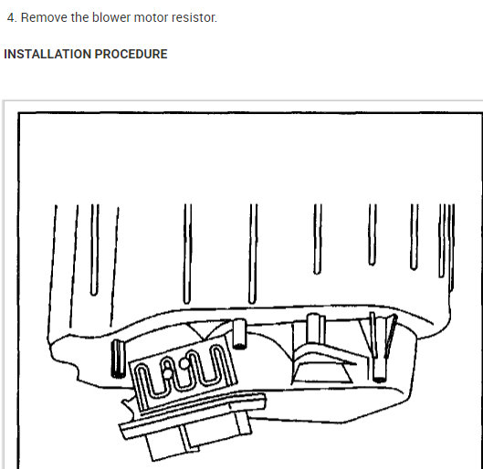

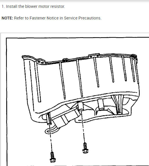

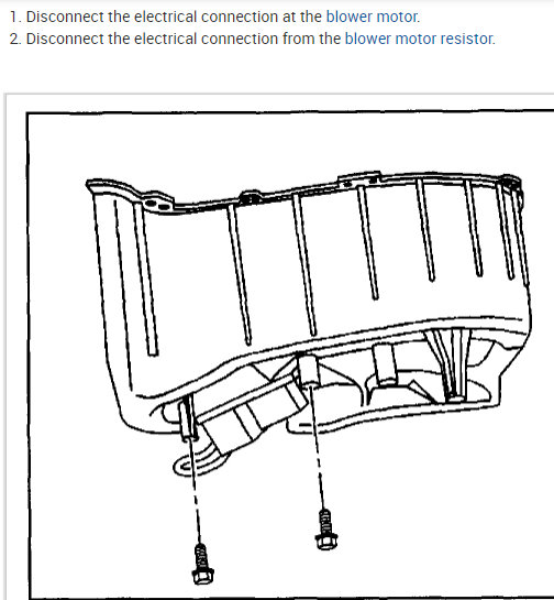

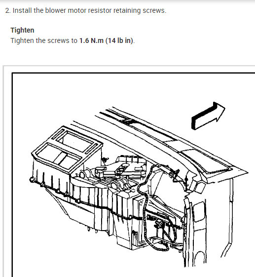

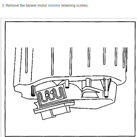

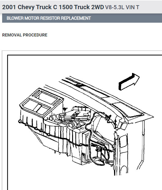

Where is it located? I have the part to replace it.
Feb 13, 2010 at 4:15 AM
DANNY L
  • 5,648 POSTS
Hello, I'm Danny.
The blower motor resistor is located next to the blower motor on the hvac box which is located under the das on the right side. Be sure to check the connector for no type of damage. Make sure the connector is not melted, burnt, or wires melted. This is a common problem on these years Chevrolet trucks. Here is a tutorial showing how to test electrical wiring. I've attached picture steps below on how to replace the blower motor resistor on your vehicle. Hope this helps and thanks for using 2CarPros.
