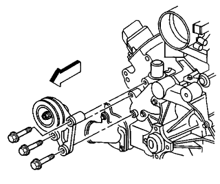

When I turn on the ignition, the lights come on and accessories work. When I attempt to start the vehicle, the starter engages and attempts to turn over the engine but the engine will not turn over as if the engine were stuck. I think I need to remove the serpentine belt and then see if the engine turns over. Where is the tensioner pulley on this vehicle? Also, I did try to start the engine again this morning. The engine will turn over but very slowly and does not start.
Oct 12, 2009 at 11:46 PM
SERVICE WRITER
  • 9,123 POSTS
https://images.2carpros.com/forum/automotive_pictures/30961_belt_1.gif

Today I removed the serpentine belt and all of the pulleys moved. next I removed the belt to the A/C Compressor and that unit is seized. I put it all back together except for the A/C belt and my Suburban is back on the road. By the way, this seized A/C Compressor would not allow the engine to start; there was so much drag from the A/C belt that the engine could barely turn over.
Do I replace the A/C Compressor? I know there is some sort of a clutch on the front end of it, so not sure what the protocol is. Change the whole unit or just part of it.
Oct 13, 2009 at 1:57 PM
SERVICE WRITER
  • 9,123 POSTS
Much better than a seized engine.
IF you want to have the a/c work then get a new, not reman compressor. Should flush the lines and replace the dryer and oriface tube.
