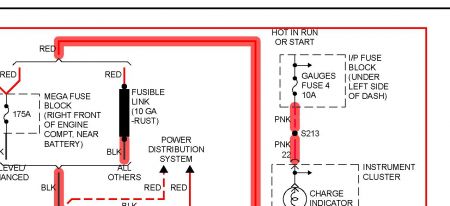

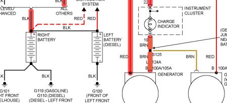

Do a voltage drop tests on the cables
https://images.2carpros.com/forum/automotive_pictures/12900_c1_46.jpg
https://images.2carpros.com/forum/automotive_pictures/12900_c2_38.jpg

as stated above have replaced cable from bat pos.to startor,alt., and checked good on alt. and bat.read 14.1 volt.on both ends meaning ground to pos.14.1 volt.and on bat.(ground) to back of alt.14.1 with no load / with load ac,rear ac,headlights,radio,put in revers 10 to low 12s volt. have tryed the jumper from bat.ground to frame no change. even jumper from bat.pos. to fuse box that carrys load no change. (to check cable) what do you mean cluster ground ?(were the ground from the frame to motor block and block to body have already done that again.with no change oh and did i mention that voltage only gos down with a combanation of things on if only one on dose not go below 13.6
