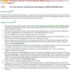

1999 Chevy Suburban K2500 3/4 ton 7.4 liter
I scan my engine with a trouble code scanner and the code is P1345: camshaft to crankshaft position correlation fault. What does that mean and how do I fix the problem.
Thank you
Apr 17, 2008 at 10:54 AM
SERVICE WRITER
  • 9,123 POSTS
This is a timing code. Try turning the distributer slightly and see if that eliminates it. See the details here:
https://images.2carpros.com/forum/automotive_pictures/30961_p1345_1.jpg
https://images.2carpros.com/forum/automotive_pictures/30961_p1345a_1.jpg
If you need diagrams to go further, let me know. I'll email you this.
