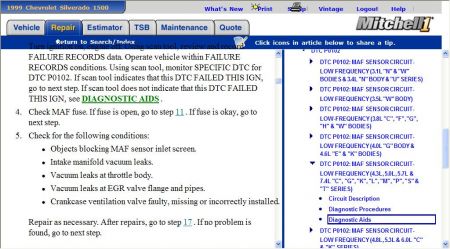

I get a p0102 code it says mass or volume circuit low input
i dont know what that means
Mar 15, 2008 at 6:21 AM
Experienced Mechanic
75,988 POSTS
P0102 has to do with the MAF sensor, check the MAF fuse.
