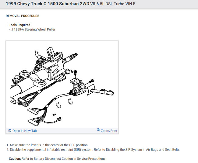

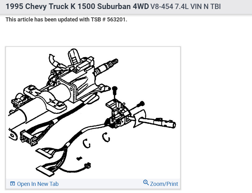

I have a broken hazard flasher switch, I believe the flasher and turn signals and wiper switch is all incorporated into one single module, what is the easiest way to replace the hazard signal switch? Do I have to pull the steering wheel and associated components to repair the problem?
Jan 16, 2009 at 4:55 PM
KEVIN12881
  • 336 POSTS

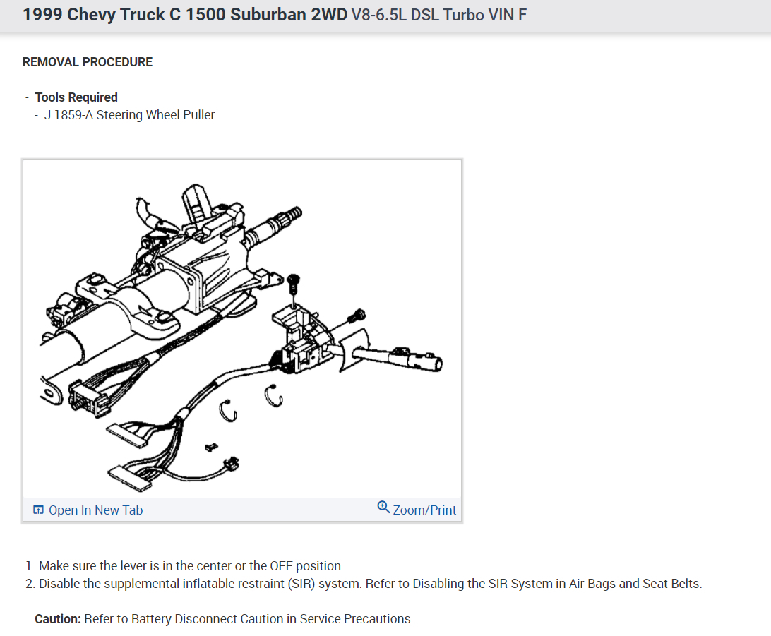

yes yes and yes. They are all together, you have to pull the wheel, but it is not too hard. Your biggest challenge is to find the part. Then get a steering wheel pully, advanced let me rent one, And go to work. I can send you more detailed info, but lets start off with the basic. AIR BAG!!! remove air bag fuse. Two screws in back of steering wheel will remove cover. once you see the giant nut and bolt, make sure that there are arrows that show its location, if not draw with sharpie. You will also need those cool little needle nose pliers that remove those C clamps. It is not that hard just pay attention to the order of things and put back together the opposite way of removing. Check out the diagrams (Below). Please let us know what happens.

I have a 1995 K1500 chevrolet suburban. The hazard light button on top of the steering wheel column has broken off and therefore the hazard lights are stuck on. I found which fuse is connected to them and have pulled it, but unfortunately this fuse also controls the turn signals as well as the brake lights.
I'm wondering if there is an easy fix to be able to just disengage the hazard lights without having to take the car to an auto repair shop and having them completely disengage the steering column.

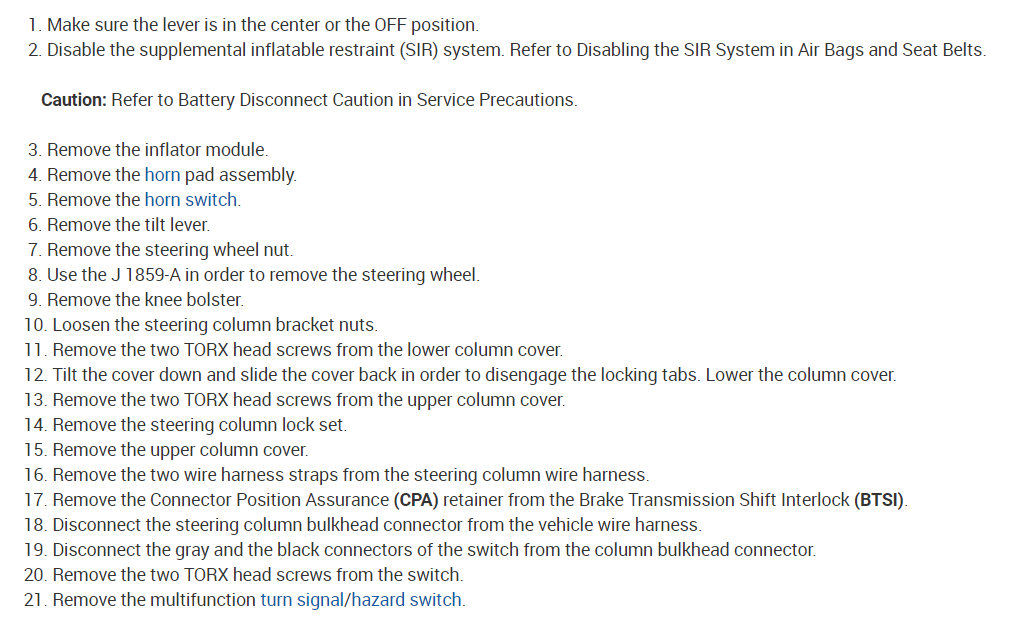

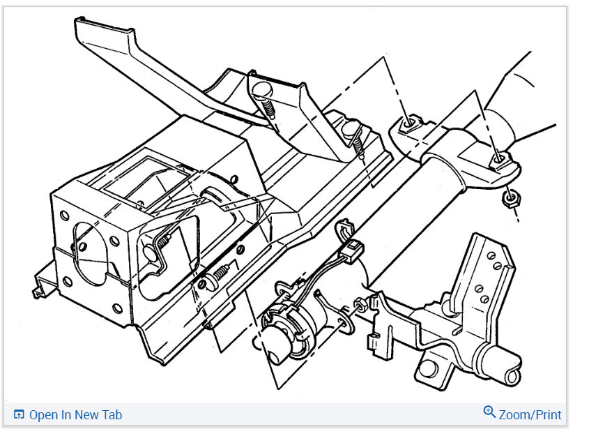

There are is no easy way to do that it's better just to replace the combination switch. Here are the instruction and diagrams below:
REMOVAL
Remove or disconnect the following:
1. Make sure the lever is in the center or "Off" position.
2. Negative battery cable.
3. Disable the SIR system.
4. Inflator module.
5. Tilt wheel lever.
6. Horn contact (if equipped with SIR).
7. Horn pad assembly (if not equipped with SIR).
8. Steering wheel nut.
9. Steering wheel using a steering wheel puller.
10. Knee bolster.
11. Loosen steering column bracket nuts.
12. Two TORX(R) head screws from lower column cover.
13. Lower column cover. Tilt cover down and slide back to disengage locking tabs.
14. Two TORX(R) head screws from upper column cover.
15. Steering column lock set.
16. Upper column cover.
17. Two wire harness straps from steering column wire harness.
18. Retainer CPA and connector from BTSI.
19. Steering column bulkhead connector from vehicle wire harness.
20. Gray and black connectors of switch from column bulkhead connector.
21. Two TORX(R) head screws on switch.
22. Multifunction turn signal/hazard switch.

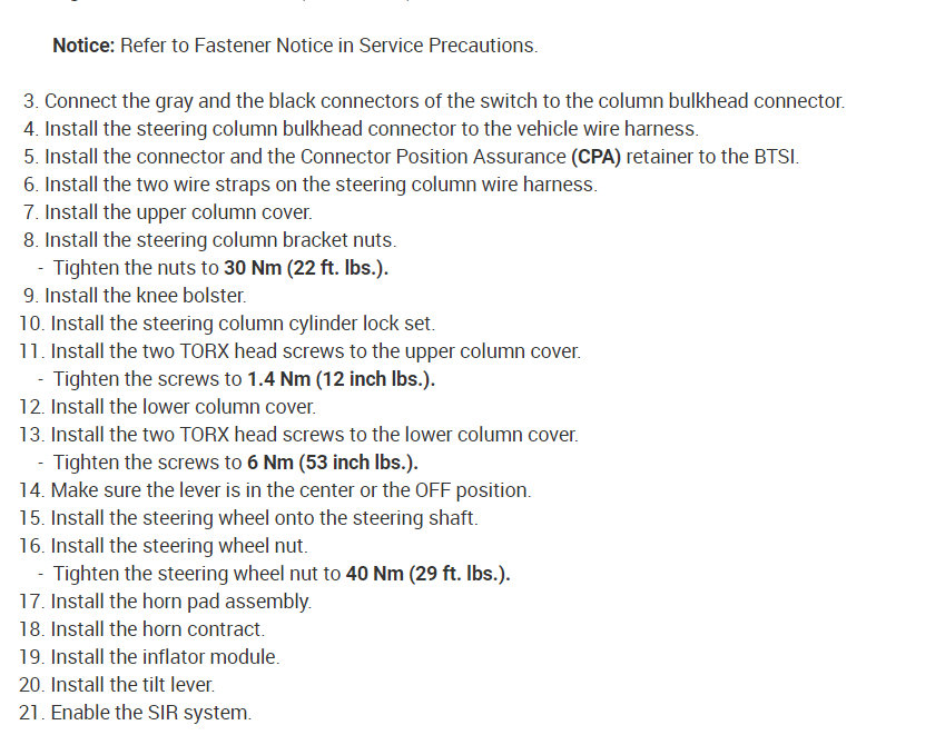

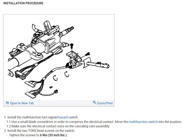

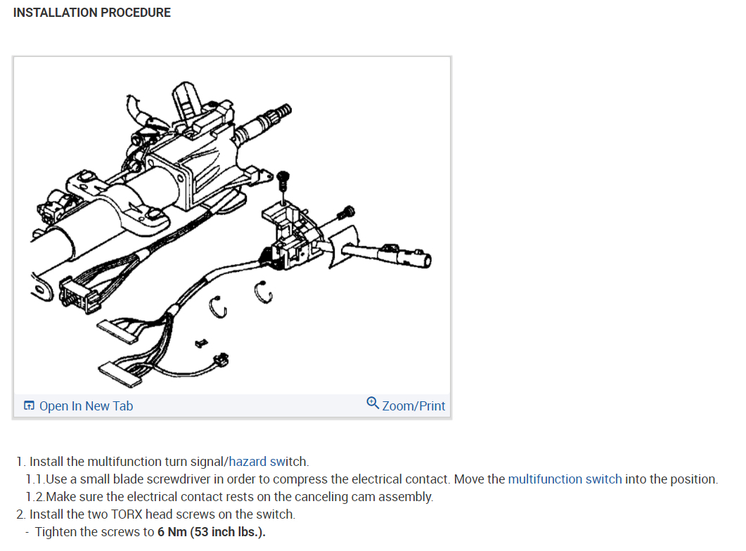

INSTALLATION
CAUTION: Always use the correct fastener in the proper location. When you replace a fastener, use ONLY the exact part number for that application. The manufacturer will call out those fasteners that require a replacement after removal. The manufacturer will also call out the fasteners that require thread lockers or thread sealant. UNLESS OTHERWISE SPECIFIED, do not use supplemental coatings (paints, greases, or other corrosion Inhibitors) on threaded fasteners or fastener joint interfaces. Generally, such coatings adversely affect the fastener torque and joint clamping force, and may damage the fastener. When you install fasteners, use the correct tightening sequence and specifications. Following these instructions can help you avoid damage to parts and systems.
Install or connect the following:
1. Multifunction turn signal/hazard switch.
- Use small blade screwdriver to compress electrical contact and move multifunction switch into position.
- Electrical contact must rest on cancelling cam assembly.
2. Two TORX(R) head screws on switch. Tighten to 6 Nm (53 lb in).
3. Gray and black connectors of switch to column bulkhead connector.
4. Steering column bulkhead connector to vehicle wire harness.
5. Connector and retainer CPA to BTSI.
6. Two wire straps on steering column wire harness.
7. Upper column cover.
8. Steering column bracket nuts. Tighten to 30 Nm (22 lb ft).
9. Knee bolster.
10. Steering column cylinder lock set.
11. Two TORX(R) head screws to upper column cover. Tighten to 1.4 Nm (12 lb in).
12. Lower column cover.
13. Two TORX(R) head screws to lower column cover. Tighten to 6 Nm (53 lb in).
14. Make sure the lever is in the center or "OFF" position.
15. Steering wheel onto the steering shaft.
16. Steering wheel nut. Tighten to 40 Nm (29 lb ft).
17. Horn pad assembly (if not equipped with SIR).
18. Horn contact (if equipped with SIR).
19. Inflator module.
20. Tilt wheel lever.
21. Negative battery cable.
22. Enable the SIR system (if equipped).

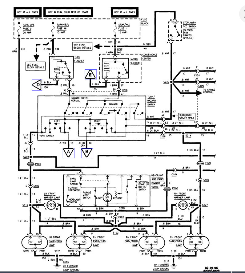

Any kind of schematic about how the hazard flasher is designed would be extremely helpful.

As mentioned earlier the only possible solution for this is to have the switch in the off position and then remove the flasher. This will allow everything else to work but not the hazards. Clearly that does not solve your issue.
To answer the last question, there is no one wire that runs to the hazard switch that can be removed.
Unfortunately the only solution for this is to replace the switch. Please let us know if there is anything else needed and we can help out. Thanks
