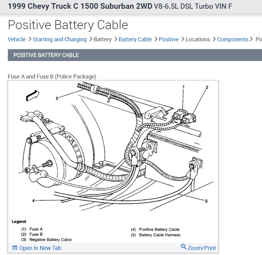

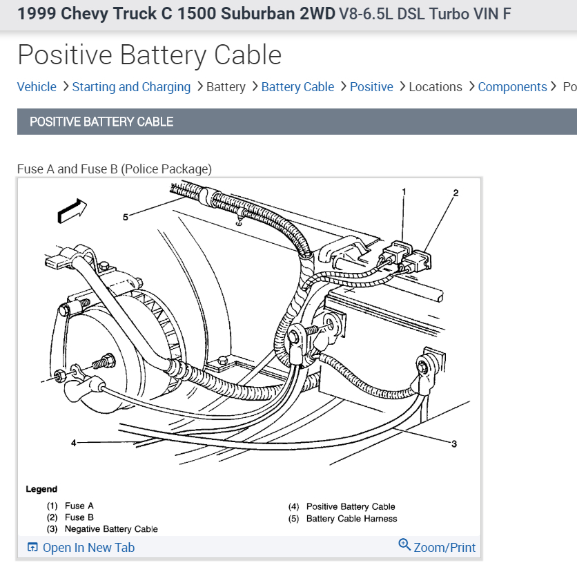

Where Is the fusible link for the starter?
Mar 7, 2010 at 1:47 PM
  • 75,992 POSTS
The fusible link is between the alternator and the battery positive post. There is a fusible link on starter. Check out the diagrams (Below). Please let us know if you need anything else to get the problem fixed.
